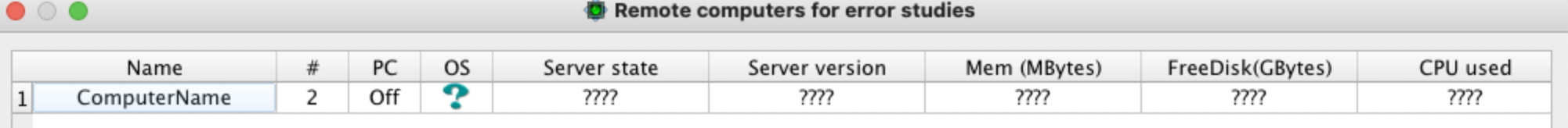

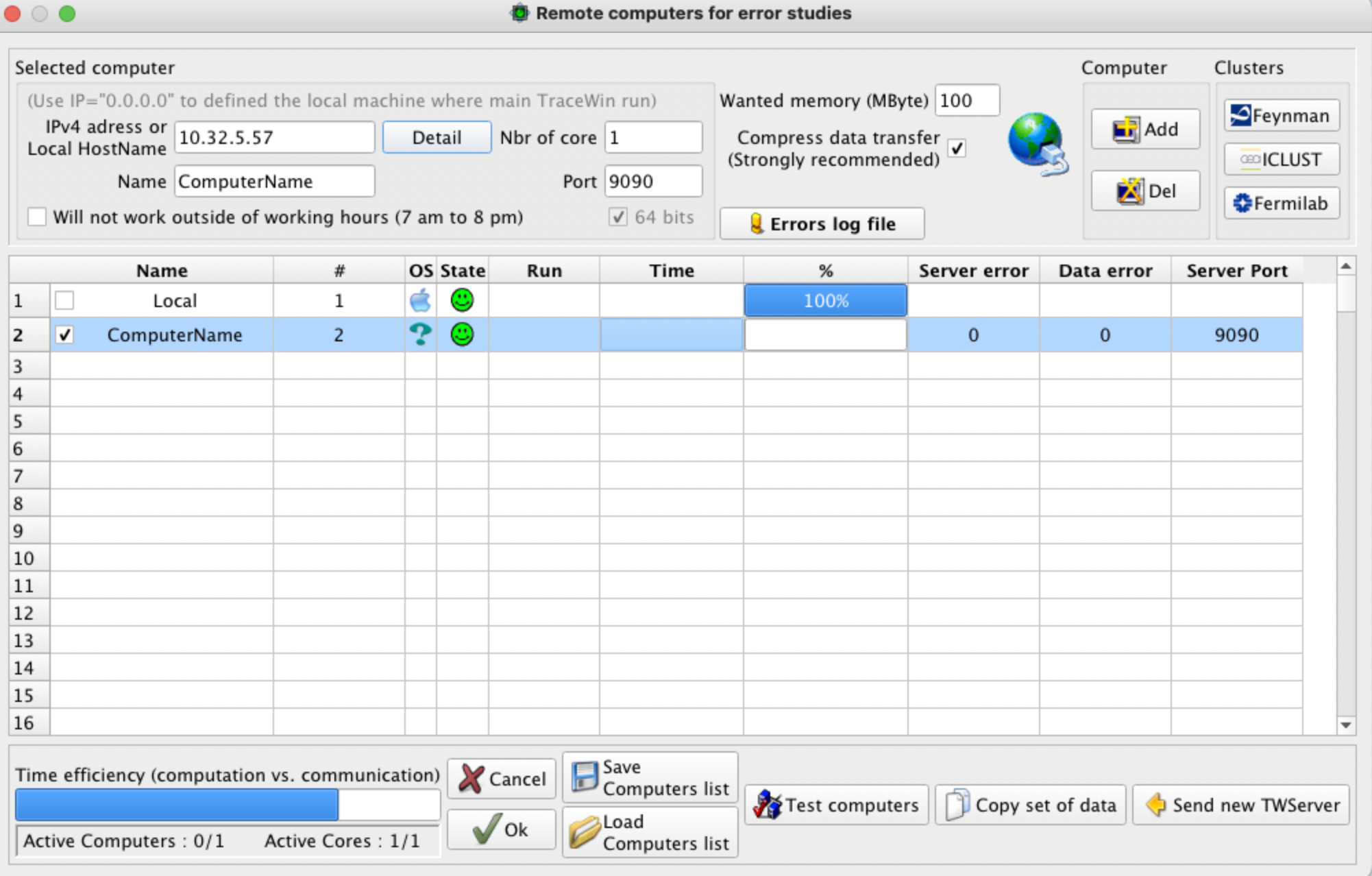

I have been trying to add a remote computer for error studies but it seems like the computer cannot be found:
Screenshot 2025-09-15 at 09.02.09.png (1.13 MiB) Viewed 36 times
Screenshot 2025-09-15 at 09.02.17.png (105.95 KiB) Viewed 36 times

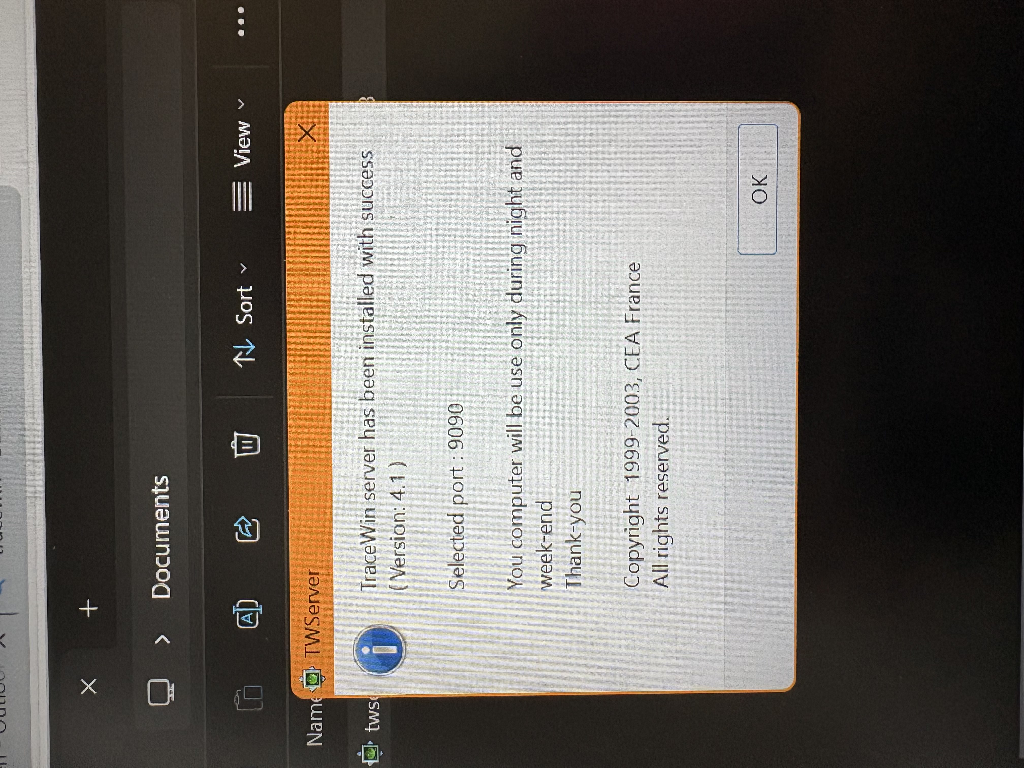

I think it is because it is only allowed to be used outside of working hours and the weekend as this popped up when I installed the server:
Is there any way I can change this setting or am I doing something else wrong?

I'm completing my answer because, regardless of the FTP connection required, your machine is indicated as OFF, which means you can't access it via a simple PING. Have you tried a simple PING?
