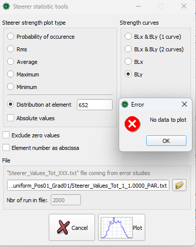

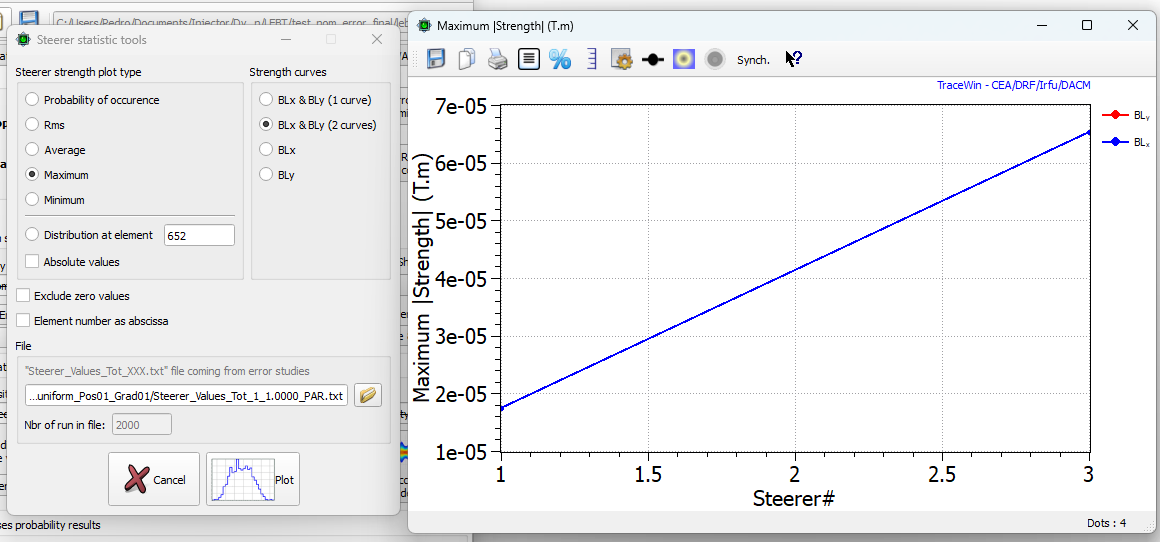

The problem I am experiencing is when I try to plot the steerers values in an error study. I am attaching a screenshot where you can see that when I select the two-curve representation of the Blx and BLy values, only one curve is plotted. I have verified that this curve corresponds to Blx.

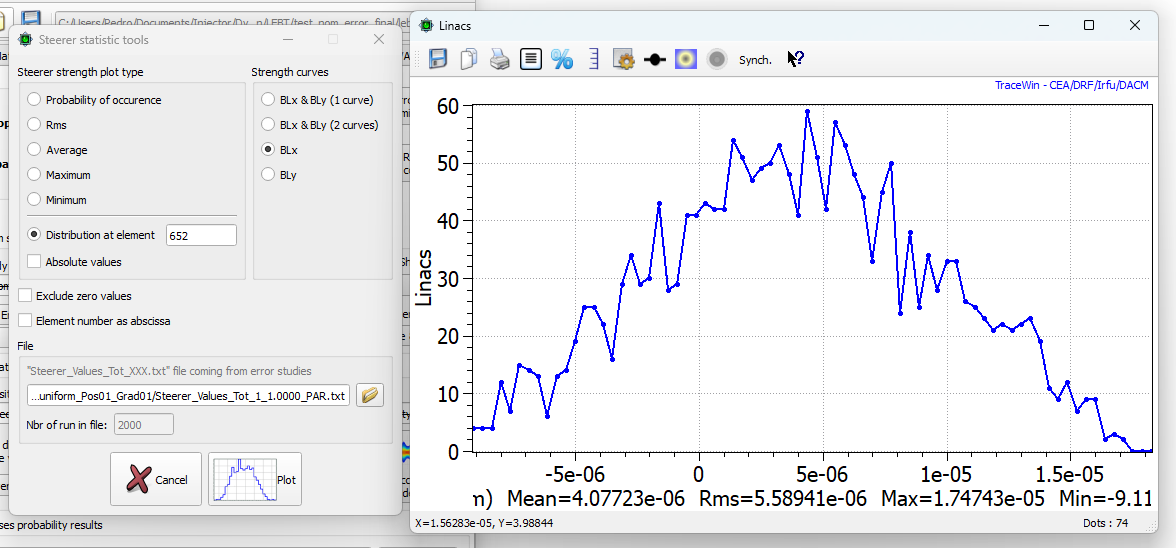

Similarly, when I try to represent the distribution of the steerers' values for Bly, I get an error, which does not occur when I try to represent Blx (I have also attached screenshots).

Dear Pedro,
I see now.
It's fixed in the last release.
I see now.
