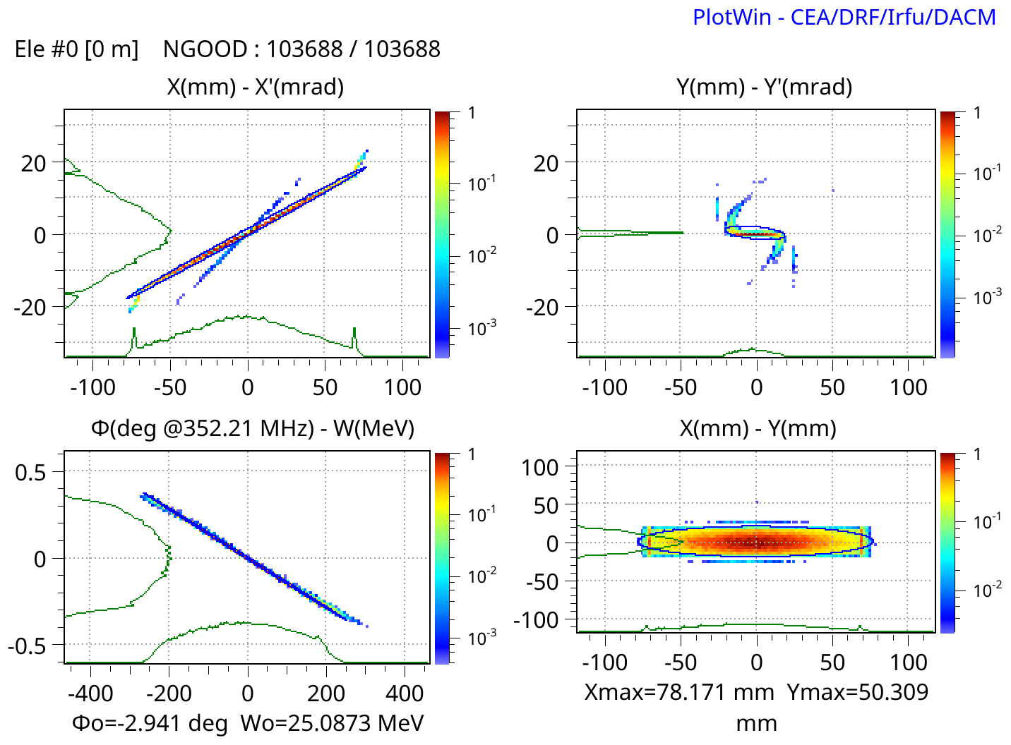

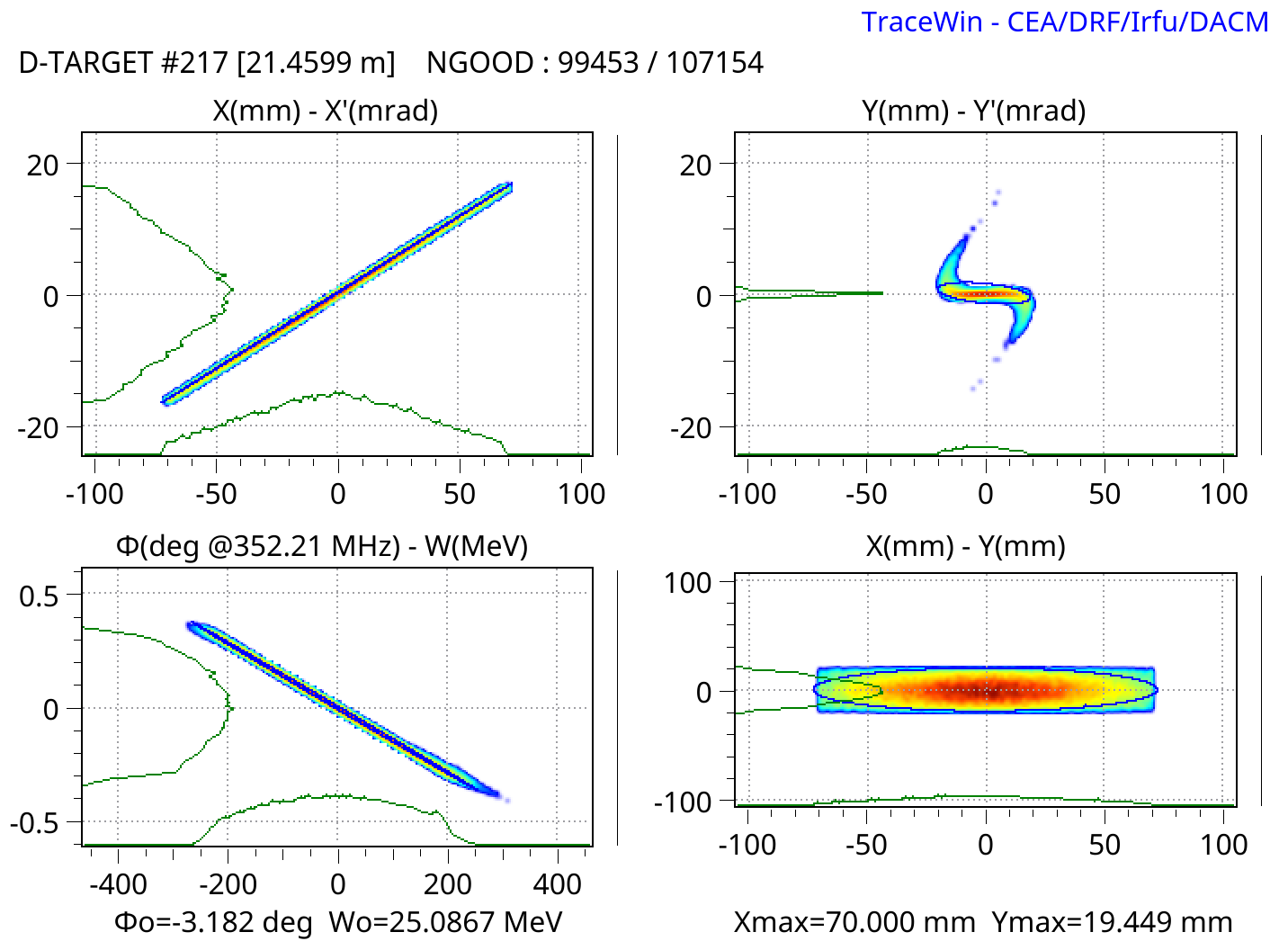

I must add that I witness some instabilities in the number of particles saved in the dst compared to what's displayed in TraceWin.
For example, today there's a huge gap that can be seen in the screenshots below.
a) TraceWin
b) As seen in PlotWin
I tried saving only visible particles, and obviously there are other particles saved.
