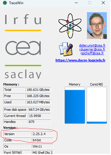

Thanks for your recommendations.
I updated to 2.25.2.4.
I attached the results of a short run. (I removed the last lines of the file where the type of errors is printed out).
1) The title of the last column is "Emit_6D/Emit0_4D-1"
2) The runs 7 (line 9) and 15 (last line) both present a decrease of 2D-emittances, 4D- and 6D, without beam losses. (The same results persists).
Thanks for your help and time,

Re: 4D & 6D emittance by errors study
Dear Brune,
I'm sorry, mais the last version is 2.25.2.9 !!
Please upgrade your version
