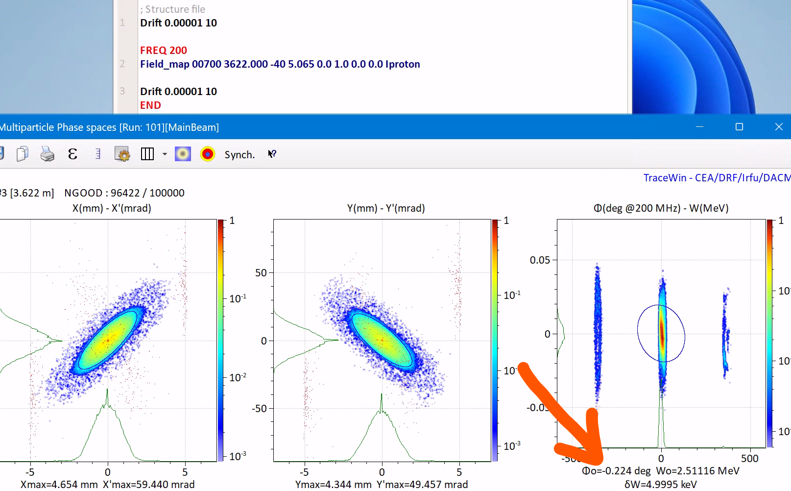

Drift 0.00001 10
FREQ 200
Field_map 00700 3622.000 0 5.065 0.0 1.0 0.0 0.0 Iproton
Drift 0.00001 10
END
But it is not work for me: Beam energy much too low (<1e-6 eV)
My question is: in this RFQ field-map case, should the lattice command FREQ remain at the physical RFQ frequency, 200 MHz, or should it also be reduced to 12.5 MHz? More generally, how can TraceWin distinguish the bunch frequency used for space-charge periodicity from the RF field frequency used by the field map?

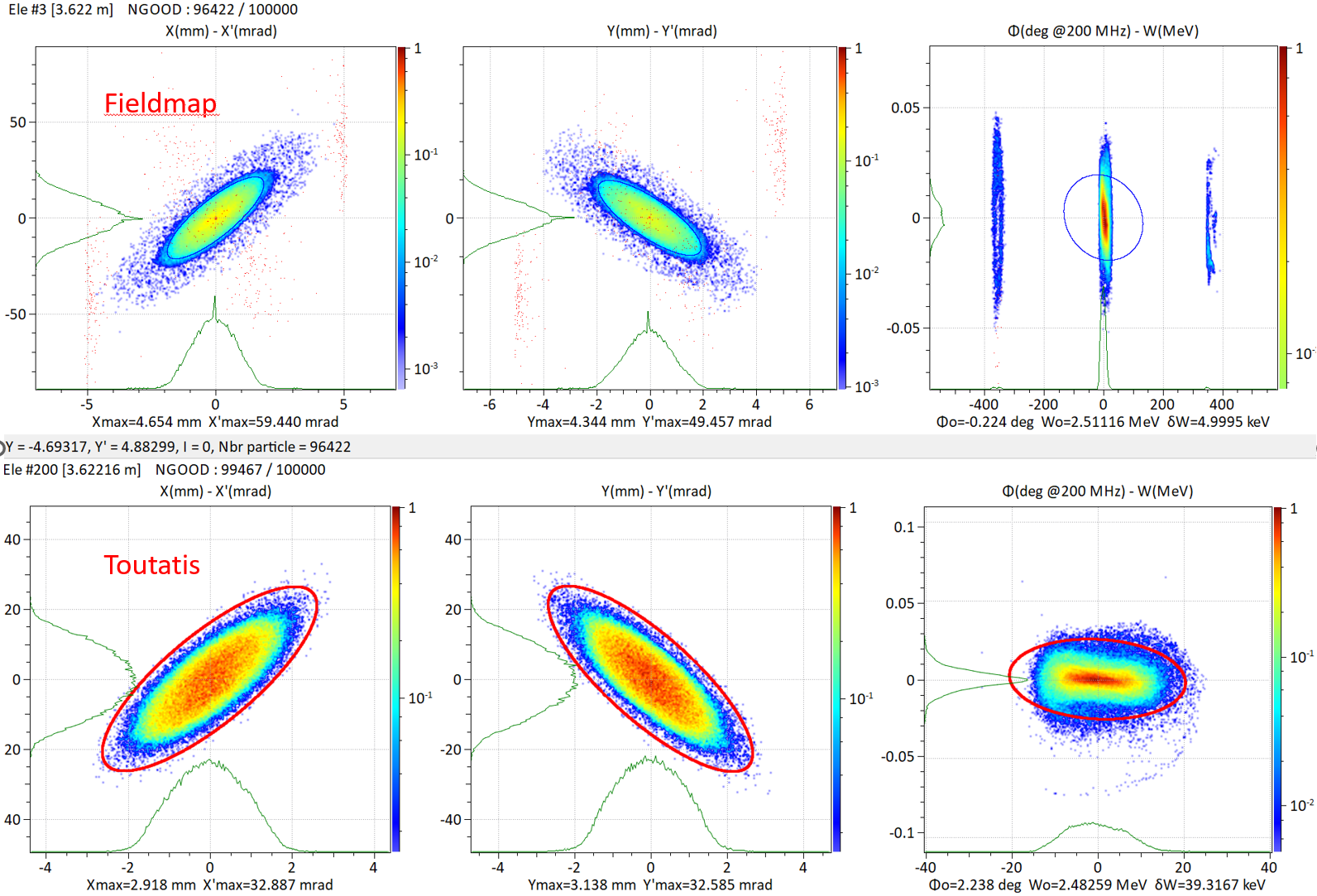

Hi Didier,
In my side,the transverse phase space is very different between the RFQ field map and Toutatis:
I am curious why there is such a significant difference.
Shuo
