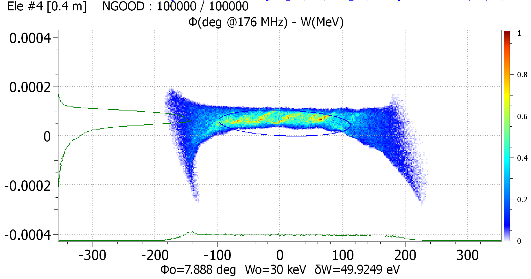

Related to this topic, I simulated a 30-keV DC proton beam in a 400m drift.
First, with a beam current of 4 mA, as shown next:
My question is the head-tail dispersion, as it is DC beam, I was expecting did not see that border effects due to the periodic conditions.

You are right.
TraceWin (and PICNIC) are natively written for bunched beam.
The way we "simulate" cw beam (as described before) is a little bit tricky (not perfect) and then can produce unexpected effets on beam border. (~-180° and ~+180°).
The effect shown here is small (<1% (30eV) and has probably no impact on the beam transportresults.
Did you observe correlation between these particles and their position in transverse phase-space ?
For example, by selecting particles in (phase-energy) phase-space and observing their position in transverse phase-space ?
It is possible that, at the start of the simulation, there is hidden correlation between energy and transverse distribution :
- Example 1 : 2 particles with the same kinetic energy but different angles have the same total speed, but different longitudinal speed. This can also contribute to beam elongation.
- Example 2 : 2 particles with the same kinetic energy at different radius don't have the same potential energy (and then total energy) because of space-charge potential. In they transverse oscillation, they are deccelerated or accelerated depending on their transverse position.
