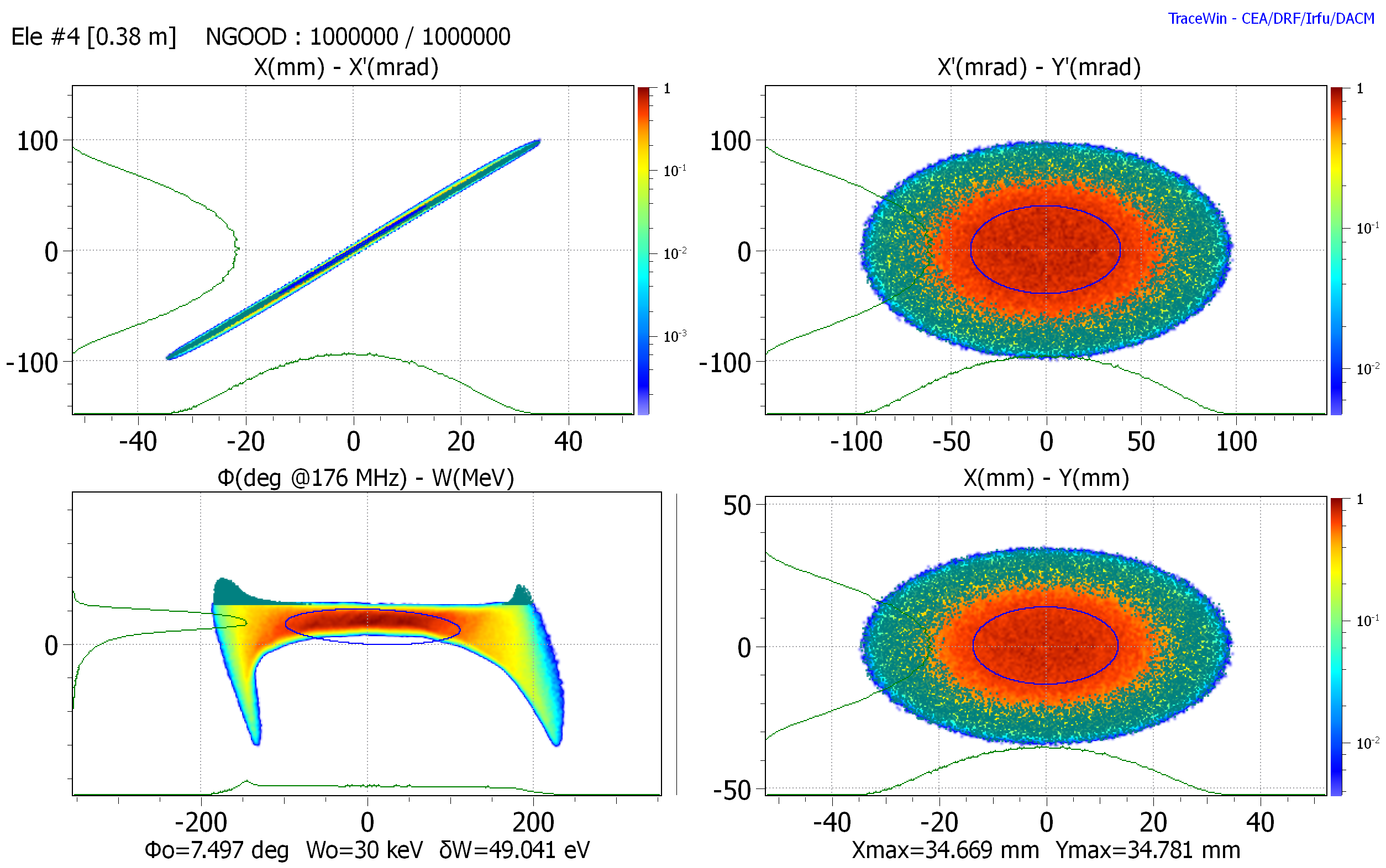

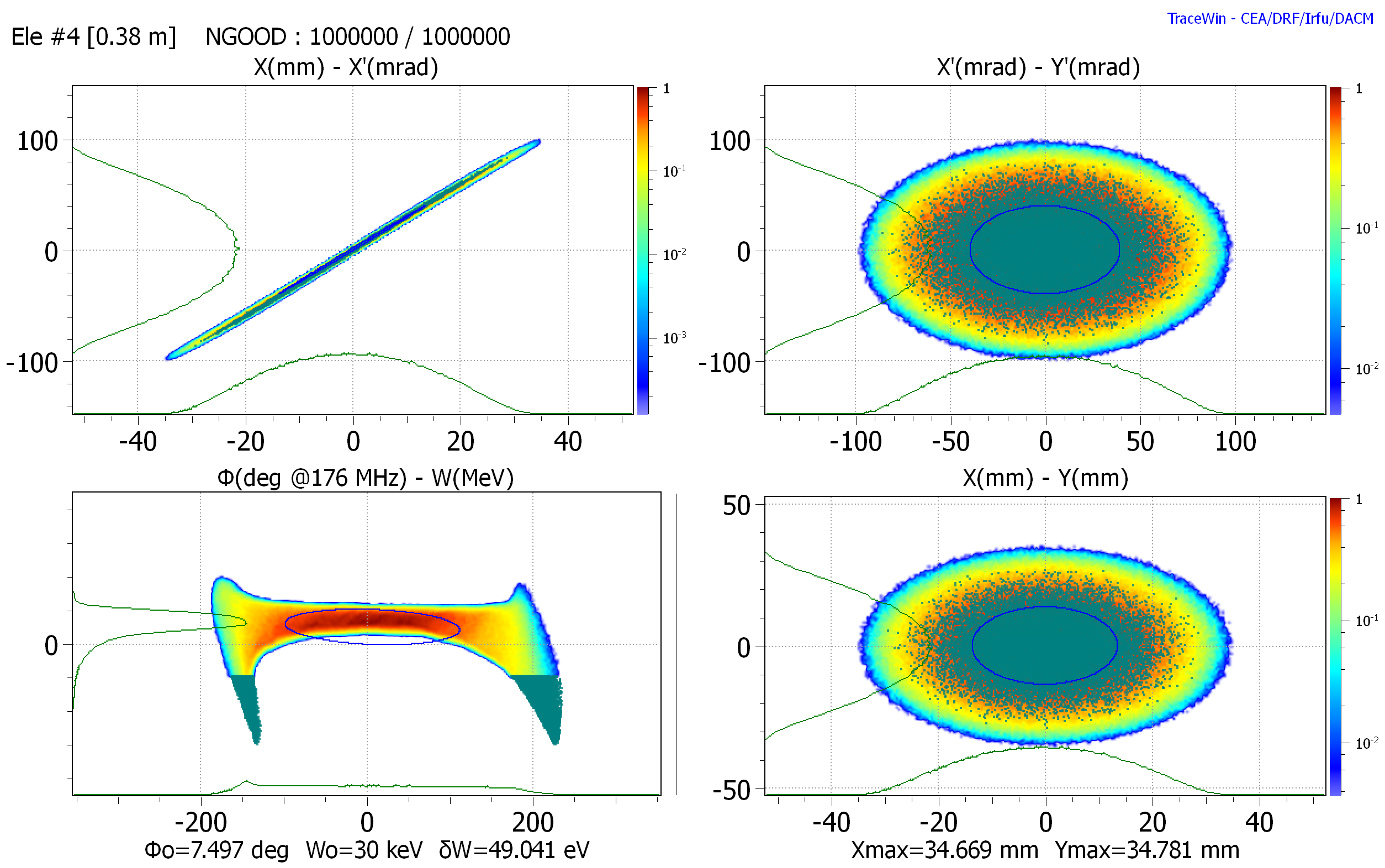

1) Did you observe correlation between these particles and their position in transverse phase-space ?
For example, by selecting particles in (phase-energy) phase-space and observing their position in transverse phase-space ?
Ans.
Yes, the low-energy particles are located at the center of the bunch:
And the high-energies, particles are located at the halo part
From what I understand, the particles in the core are more affected by the space charge than by the charge of the nucleus itself, resulting in a slight difference in energy.
Something worth mentioning is the delta W, an additional increase in energies due to the expansion of the beam by the space charge.

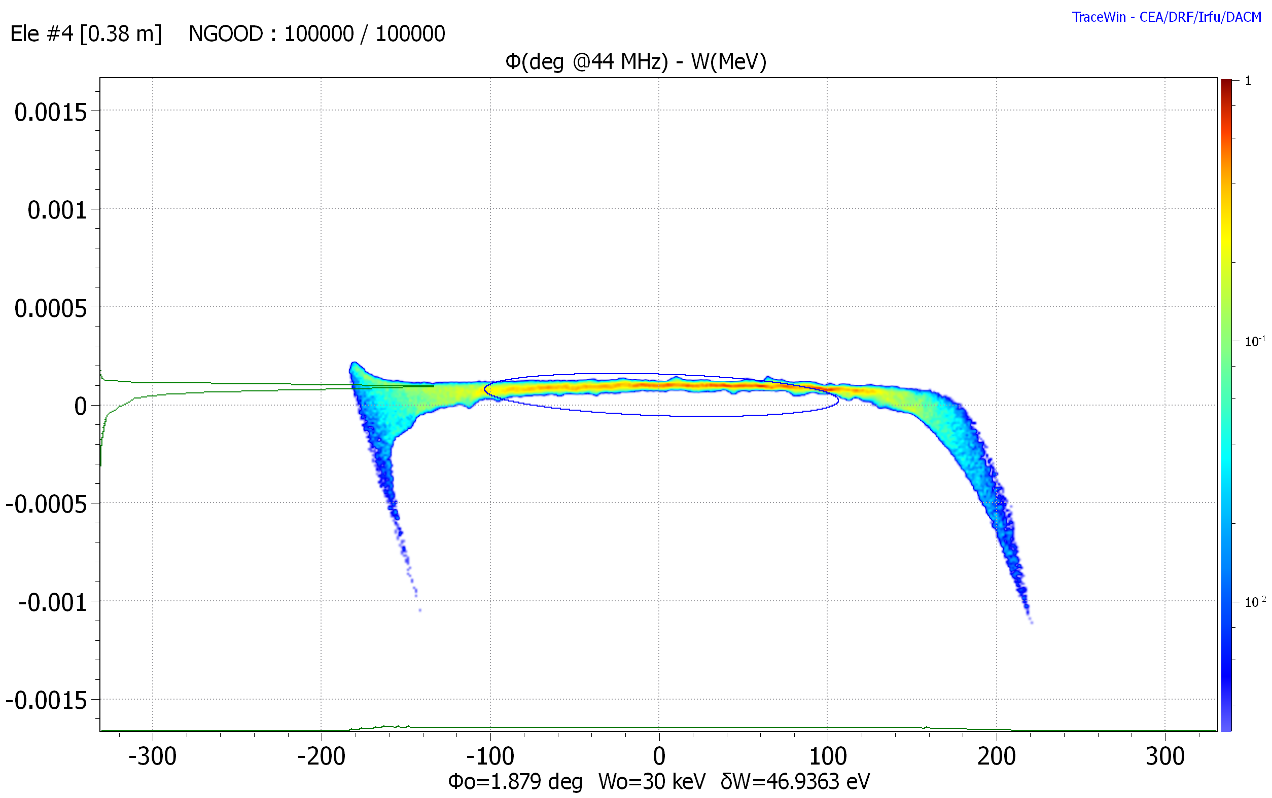

I followed your advice, however, the energy change increased, as shown in the next figure.

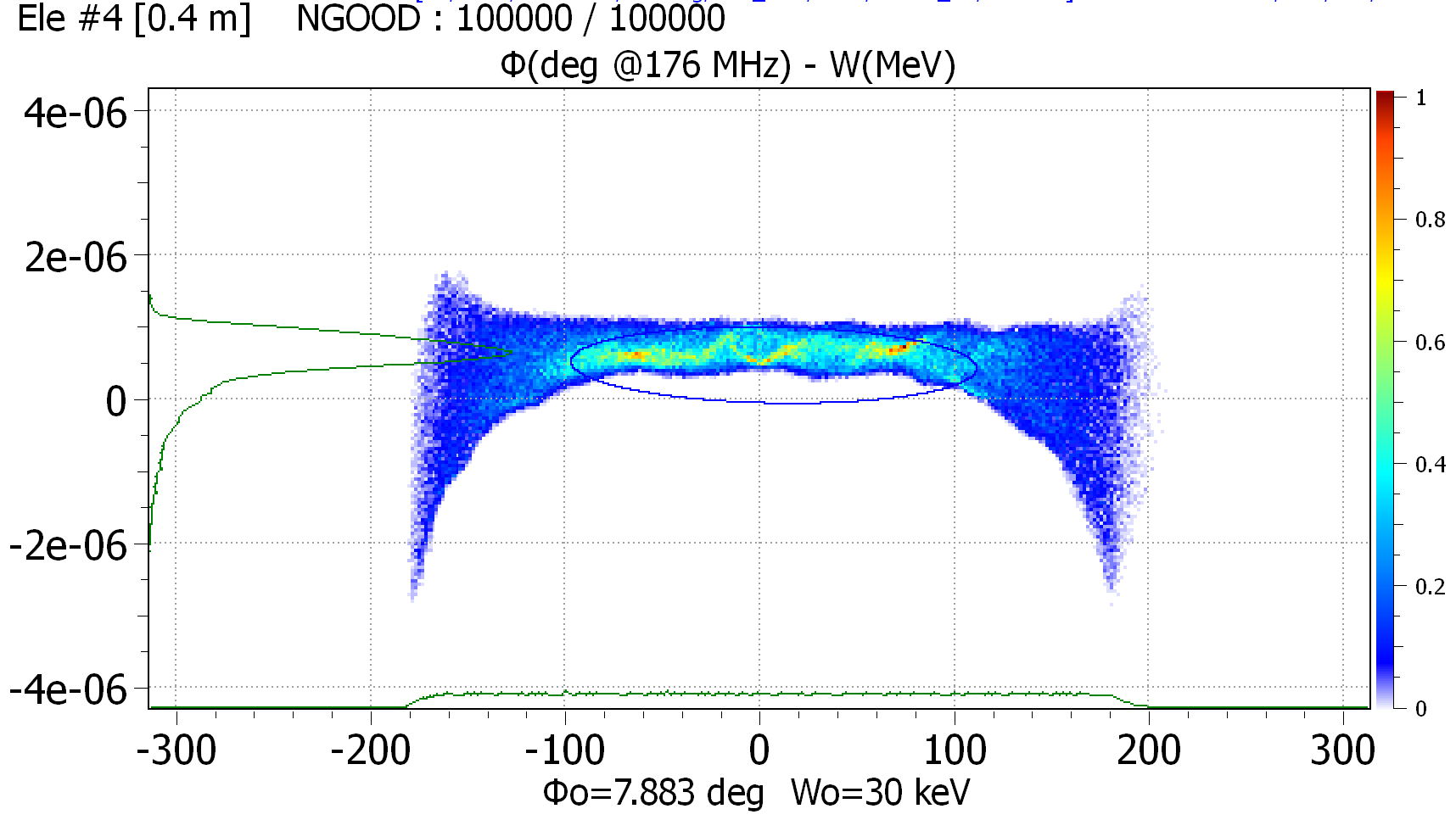

I simulated case with a lower current 0.04mA.
The effect was reduced.
