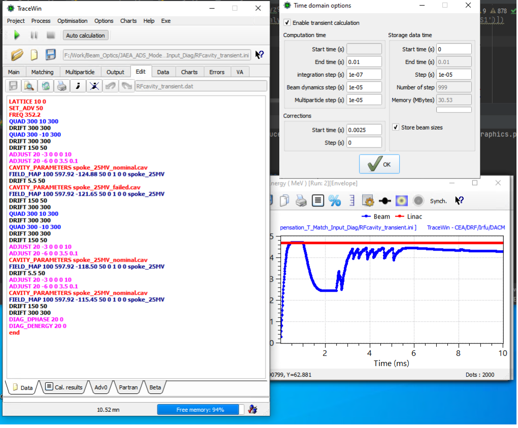

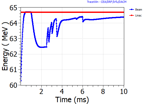

Changing of topic. I would like some help to apply for the cavity compensation when I simulated the transient effect of an RF cavity.
So far, I combined the two examples "cavity_failure_recovery" and "RFcavity_transient" (I attached some pictures).
The error starts at 1ms and "applied correction " 1.5 ms after the failures (2.5ms)
However, I did not succeed. Could you give me some advice?

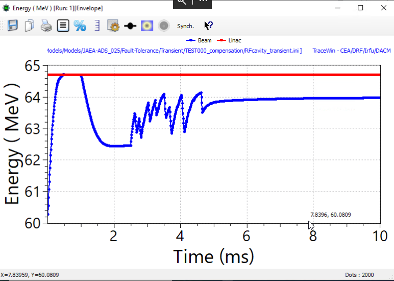

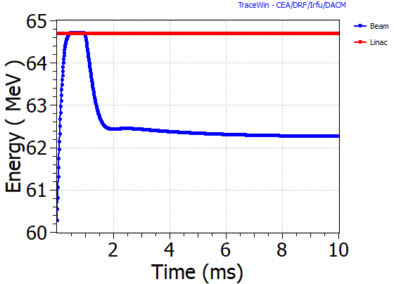

Next please send me you project files, because I'm not sure to was able to rebuilt exactly what you did. Anyway, secondly I don' know also what meaning "yo didn't succeed".
So I made simulation without any correction and I have the following result concerning the output energy according to time.

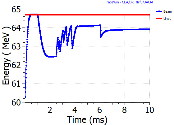

Now I add correction like you starting at 2.5 ms and I get following result
That seems better but not perfect, probably 3 cavities not enougth to compensate correctly the failure, so, I incease the field marging, increasing the "MargeField" parameter in "spoke_25MV_nominal.cav" file from 0.7 (70%) to 4 and I get new result better.
Now, I don't know if from your point of view this is a success. It's probably not the right correction scheme, more cavities should maybe be used, but I do see an improvement.

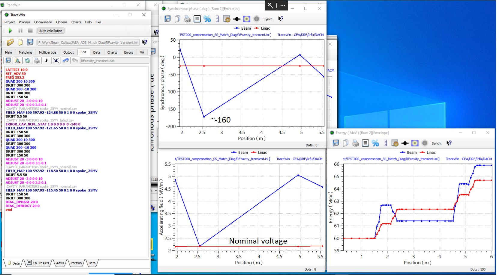

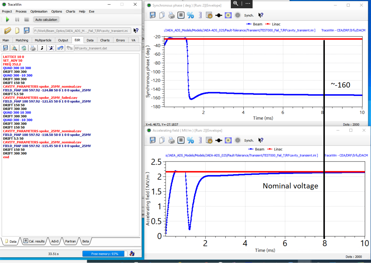

Thank you very much for your help. Follows the previous discussion. My goal is to develop a correction scheme in the stead-state and tested if the results are compatible for the same condition at a given time in the transient-state.
For example, using the example file "RF cavity transient", I tried to implement a correction scheme similar to "cavity_failure_recovery".
For the "RF cavity transient", I reproduced the same failure conditions at 8 ms (phase ~-160 deg and same nominal voltage), as is shown in the next figure

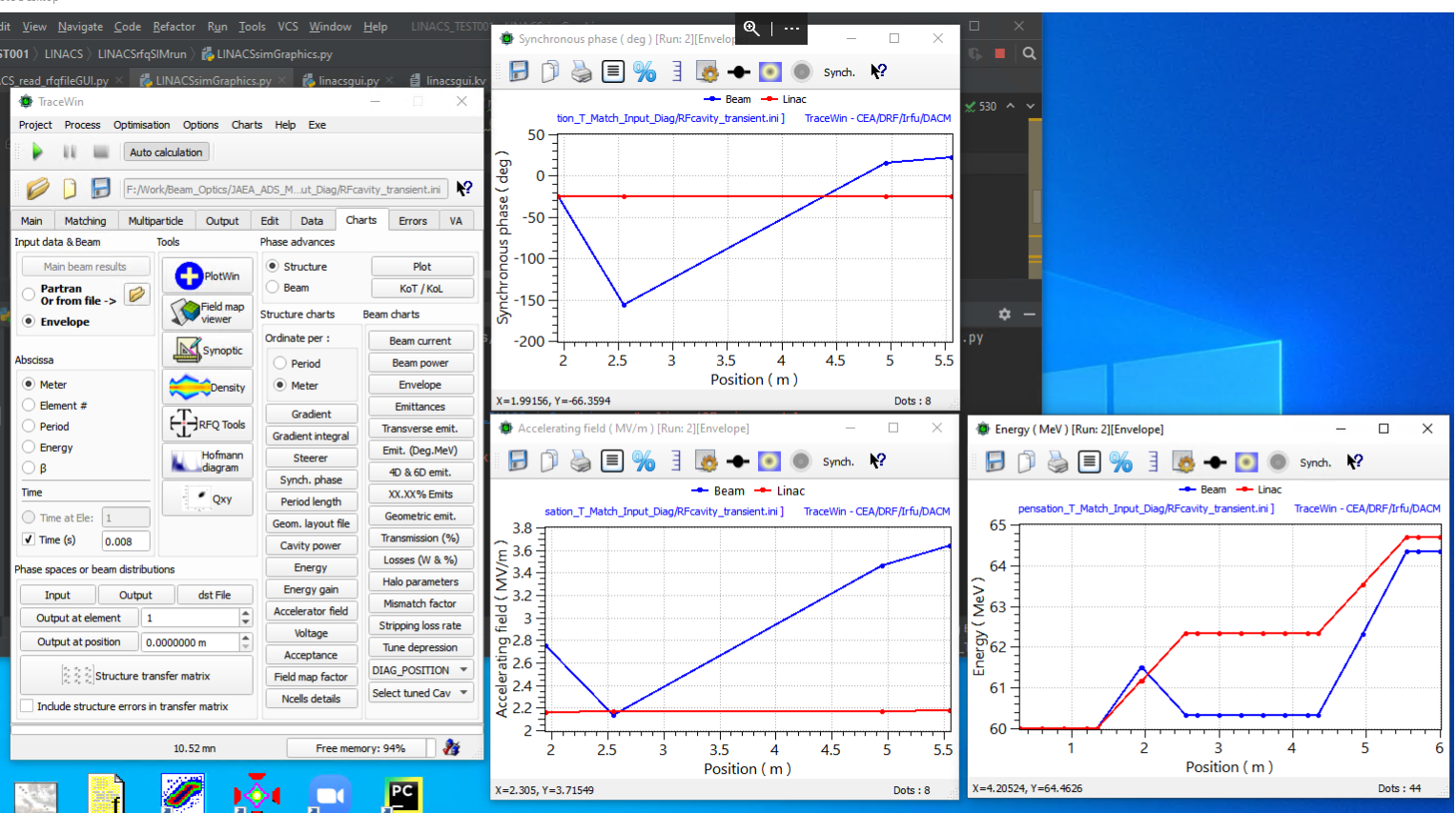

Then, I simulated the failure in the steady-state to develop a compensation scheme as is shown in the next figure.
The compensation produced higher energy than baseline.
Then, I went back and added the element to make the compensation in Transient studies. I will implement the correction 2.5 ms after the beginning of the simulations (1.5 ms later than the failure). See figure
Something interesting is that in this case, the scheme produces an energy compensation lower than the baseline. This can be explained by the "Margefield" in the cavity parameters files. (By that way this Margefield parameter is the available field that can be used for compensation, you mentioned the last reply that can be used a value of 4, but this means that the nominal voltage of the cavity is multiplied by 4? Could you explain a little bit more about it? And how this value could be compared with the 5th parameter of the command "ADJUST 20 -3 0 0 3.5 0.1" used to adjust the cavity fields )
I looked in the time of 8ms, to see if the results are similar to the compensation scheme in steady-state (Fig2)
The cavities did not get as much voltage as the steady-state, even, I used the same command to adjust (perhaps it only is adjusted by the values of the cavity parameters files). However, the most interesting point is the synchronous phase for the first cavities does not change (Why?). For the steady-state all the phases of the cavities used for the matching changed. Indeed, it seems that the synchronous phase of the other cavities did not do the same. Maybe you can give some hints.

Dear bruce,
A lot of things. I tried to answer some of them, expected that solve the others :D

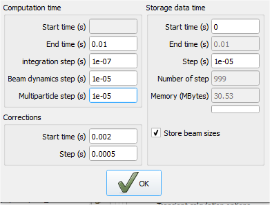

First your steady-state ddin't reach the right energy because, your number of optimization step is two low, increase to 500, the "Maximum number of iteration" in "Matching" page -> "Second step with error".
For the transient studies, decrease htis number to 10 ou 20, otherwise, that seem become instable and I don't understand why for the moment, I was still looking about that point.

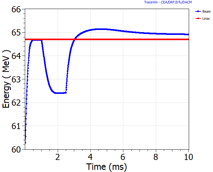

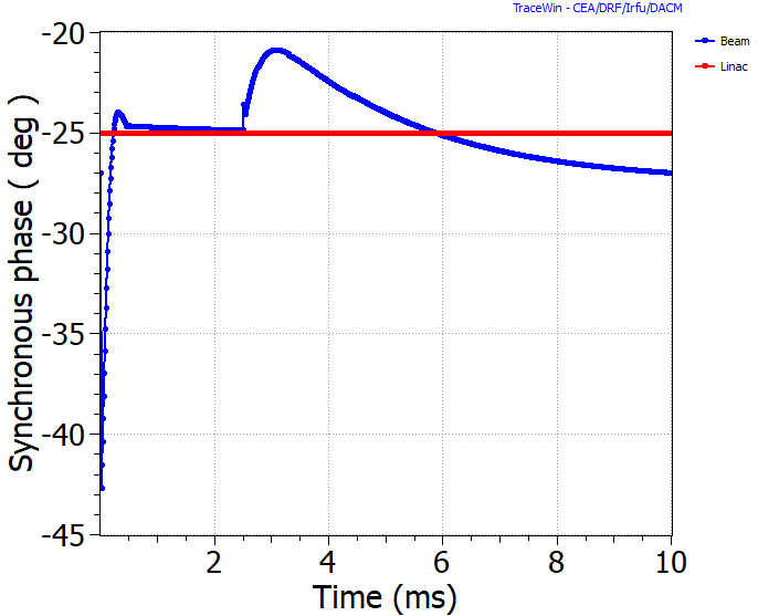

Yes, 4 means 400% of nominal voltage marging and the 5th parameter of the command ADJUST is in transient mode not an absolute limit but a variation limit for each step of optimisation. In other words don't use it to control the maximum voltage. The parameter form cavity file is the good one to control.
So using '20' for the number of optimisation and 1.7 and MargeField=1.7 I got following figures for output energy and phase synchrone of first cavity. As yo can see, on my side, it changed. I've also changed a little bit the trransient time parameters to accelerate computation.
