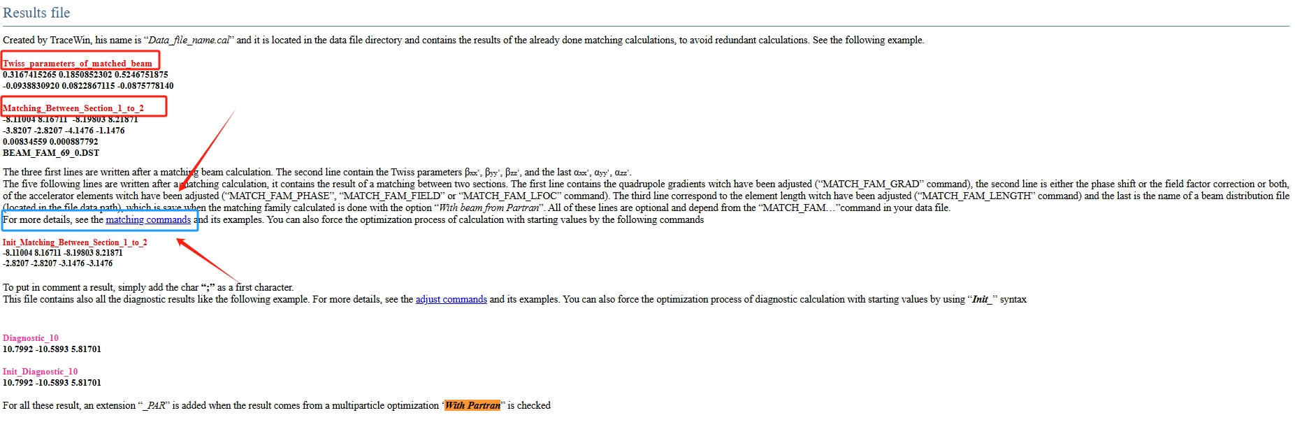

I want to understand some of the instructions for beam matching.I looked at examples in the manual, such as Figure 1.
I jumped to Matching example 1 and tried to run it to learn better, but Matching example 1 was incomplete and made it difficult for me to learn.
There are many examples such as this, can you attach the relevant documents for learning reference?

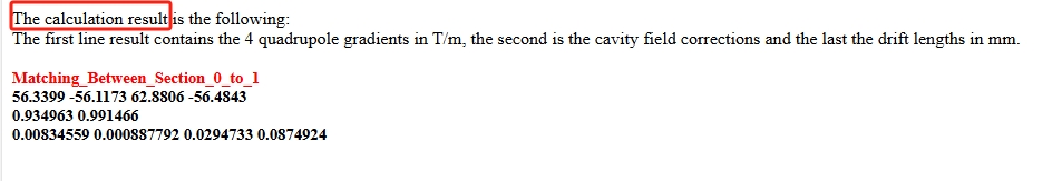

I will further study the documentation related to the ADJUST & DIAG_XXXX pair method. I attempted to run DTL_3, but I didn't see the 'Data_file_name.cal' file created by TraceWin. I aimed to reproduce some of the instructions from the manual, but I couldn't find the calculation results.
Matching_Between_Section_0_to_1
56.3399 -56.1173 62.8806 -56.4843
0.934963 0.991466
0.00834559 0.000887792 0.0294733 0.0874924
"The first line of results contains the 4 quadrupole gradients in T/m, the second line represents the cavity field corrections, and the last line denotes the drift lengths in mm. Does this mean that by using these parameters, matching between RFQ and DTL can be achieved? Also, are positive values in the last two lines indicating the increments required on top of the existing values?"

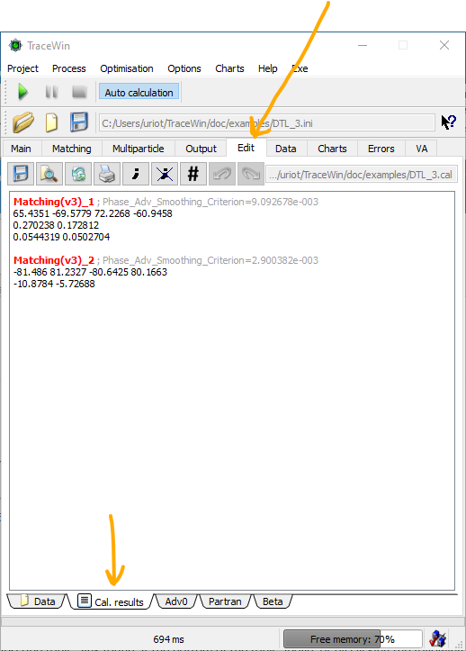

Normally once the calculations are complete you can read the results here (see image below)
Capture d’écran 2024-05-31 170508.png (42.35 KiB) Viewed 6347 times
Concerning the 3 lines, first and third are the direct value of quad( t/m) and drift (m), seconf on is the correction to apply to field amplitude of cavity
