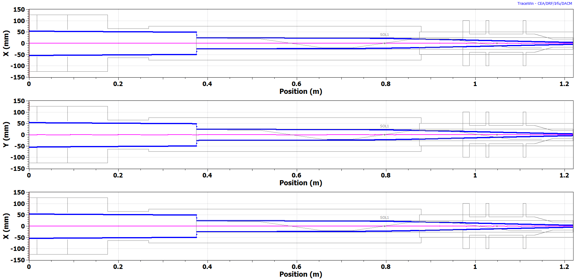

When trying to backtrack a proton beam through a LEBT, a virtual collimation is generated at the end of a fieldmap.
bact-tracking jump.png (41.75 KiB) Viewed 21690 times
It seems to be due to the fact that the later fielmap is superposed to another (problem disappears when overlapping removed).
Re: backtracking goes wild with superposed maps  [SOLVED]
Hi Angelique,
The problem come from an incompatibility with overlapping field map and aperture map during back-tracking. This bug has been fixed in the last version 2.16.16.7
