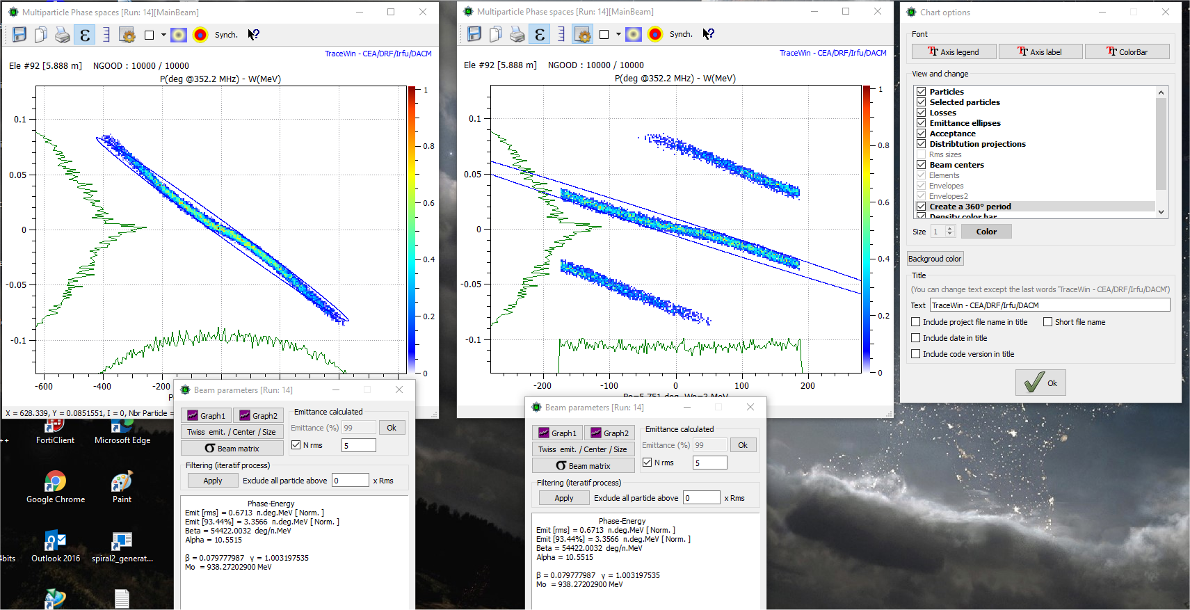

Re: Lost particles on phase
Posted: Thu 29 Jul 2021 11:15
Dear Michele,

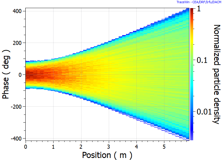

The following picture shows a large phase beam distribution with and without 360° modulo. So, as I said before, your request is already there for the beam distribution display. Is this what you wanted?
And did you want the same thing for the density plots (second picture below) ?, right?
Posted: Thu 29 Jul 2021 11:56
by comunian
thank you for the plot with 360° phase period.
May you put this options also on the density plot ?
Posted: Mon 2 Aug 2021 15:23
Dear Michele,
In the new TraceWin version, displaying of the phase density can be done modulo 360° (see options from « Mltiparticle » tab-sheet -> « Phase and energy limits).
