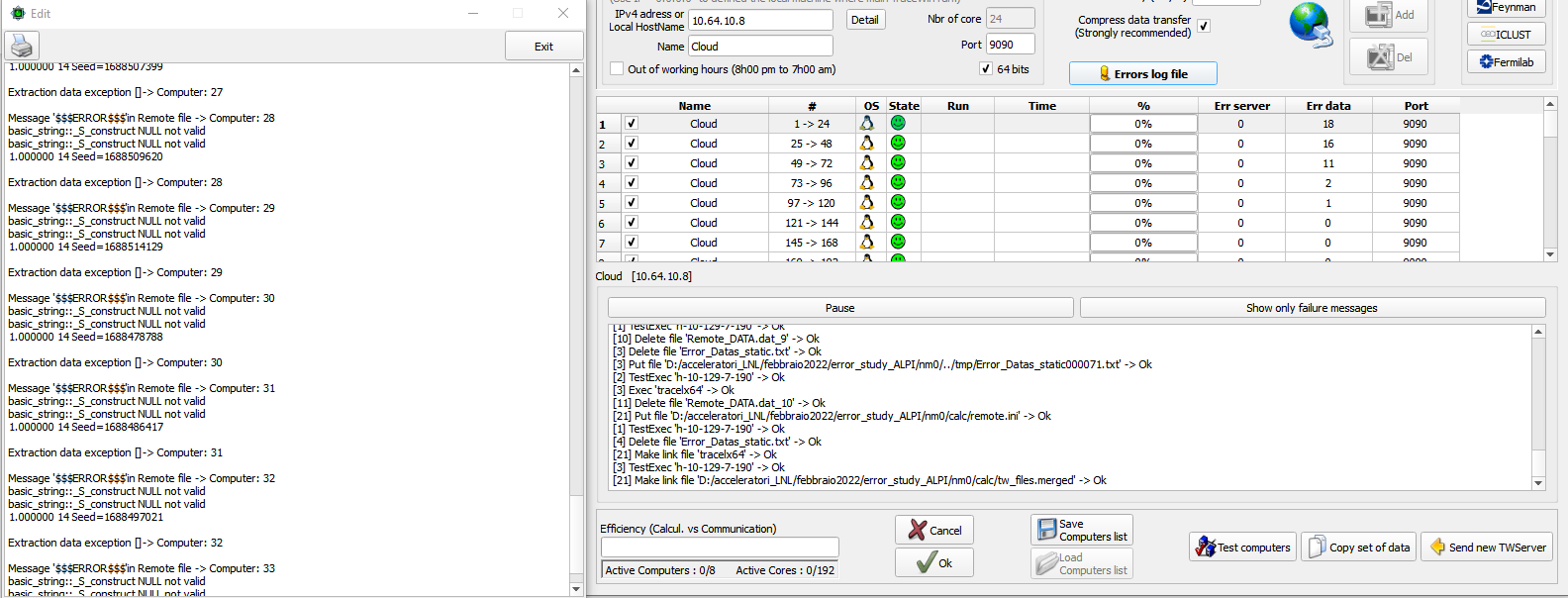

we get a lot of errors on our remote computer system. As you can see from the snapshot.
We are using the latest version of TraceWin.
May you can understand why ?

Re: Recovery runs done inside an error step
Dear Michele,
I think, it's fixed in the last TraceWin version.
