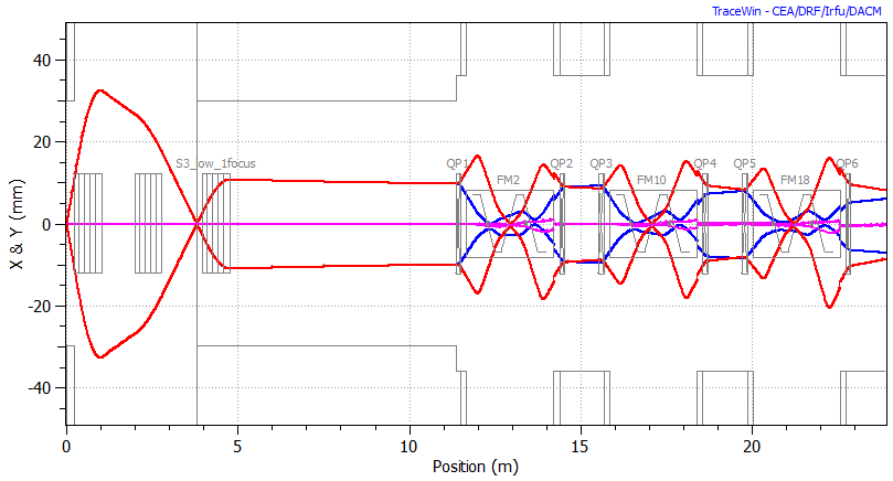

Yes, I confirm that the latest version is able to simulate your example, see the image below.
