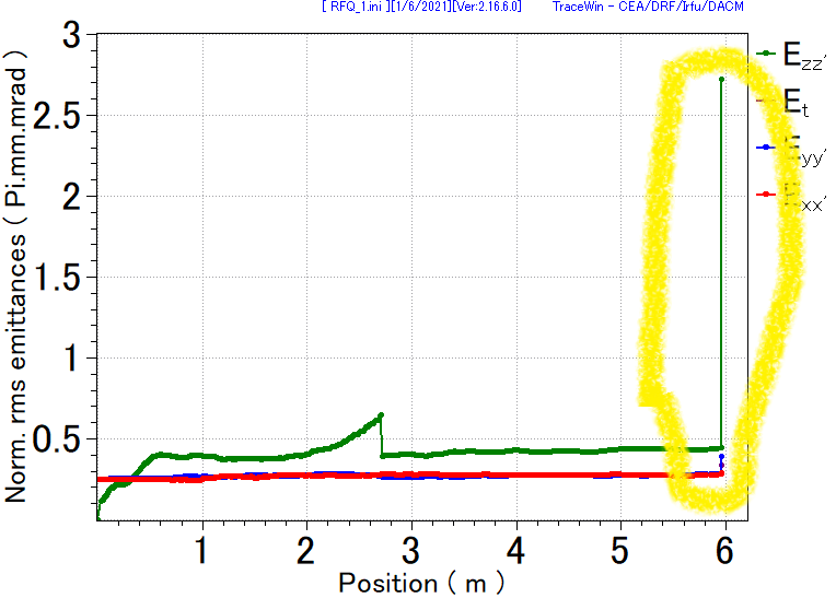

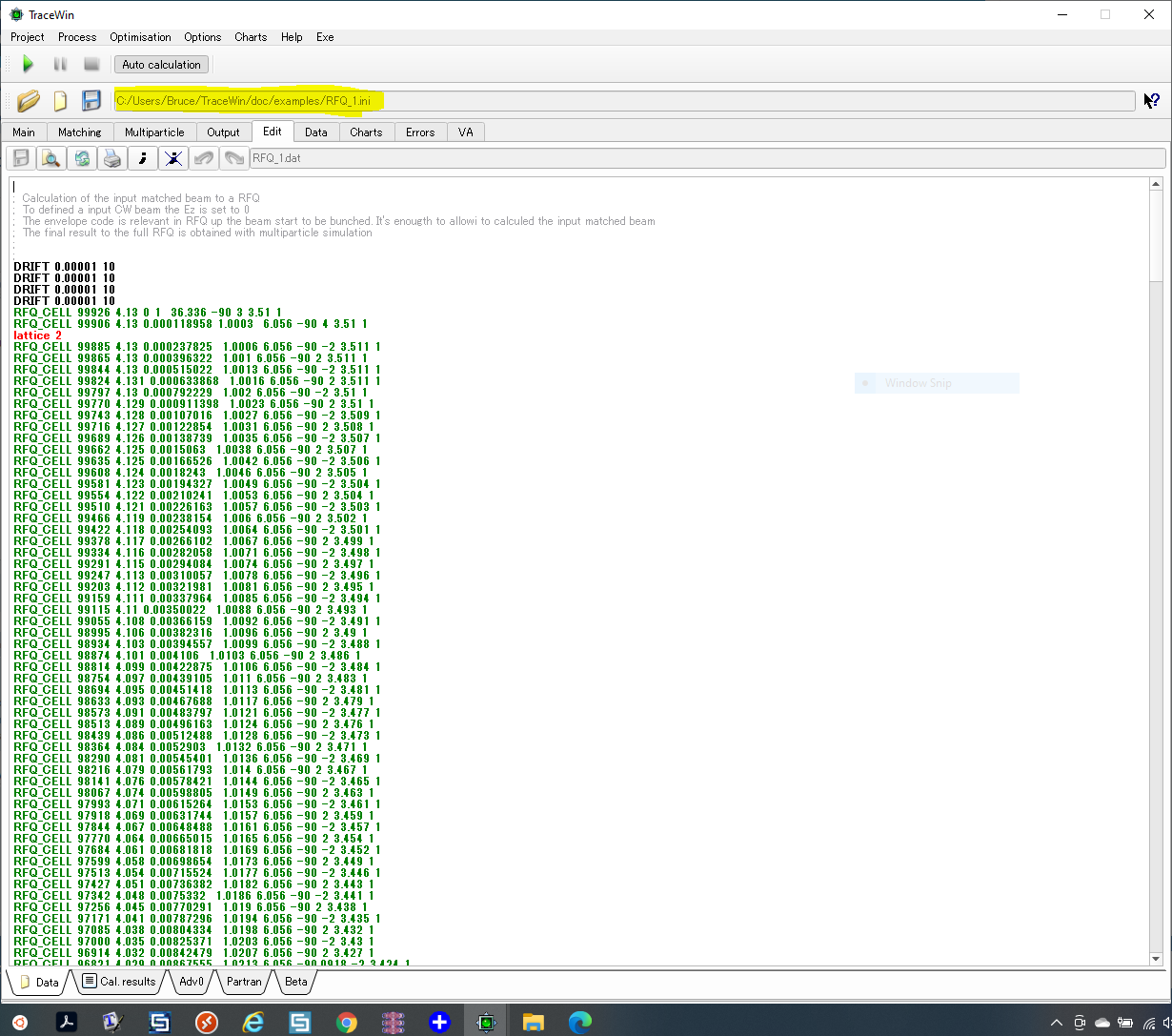

In the example "RFQ_1" (see the figure "Examples") provide by Tracewin, the longitudinal Norm_rms_emittance blow ups at the end of the lattice (See figure "Norm_rms_..")
Is that correct?

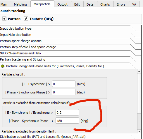

By default Toutatis excludes from rms emittance calculations the particles that are detached and far from the core of the beam.
This is not the case in TraceWin, so at the end of the RFQ when you arrive in the DRIFT elements these particles are again included in the emittance calculations and so the longitudinal emittance becomes huge. You have to exclude them also in TraceWin as shown in the attached picture.
