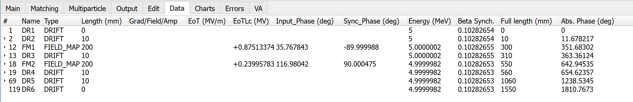

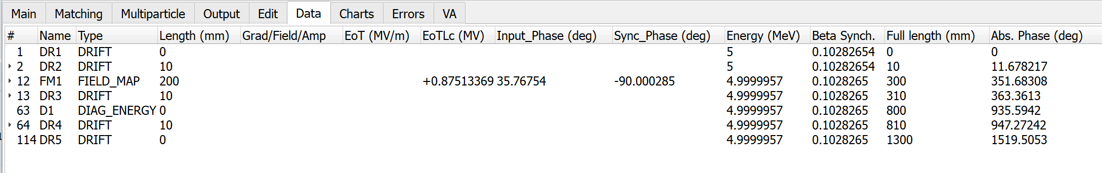

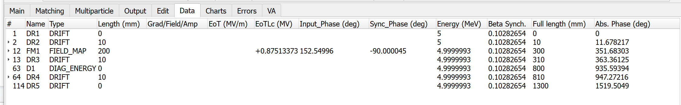

I still want to understand what is Input Phase. I have attached two screenshots. For the case of absolution phase with flag set to "1". What does the "Input_Phase" 35.76754 deg mean? When set to relative phase "0", the "Input_Phase" is 152.54996 deg.
- abs_phase.png (45.84 KiB) Viewed 14517 times
- relative_phase.png (47.96 KiB) Viewed 14517 times
Re: Field Map and phase
The last column is the absolute phase of the beam along the machine.
If "1" the RF phase of the cavity is set to beam phase + Input_phase.
If "0" the RF phase of the cavity is set to Input_phase. But here, phase error comming from beam or cavities are alway transported as le first case.
Both cases should give the same transport, but the first one normally gives input phase values similar to what should actually be put in the command control of a machine for tuning a cavity.

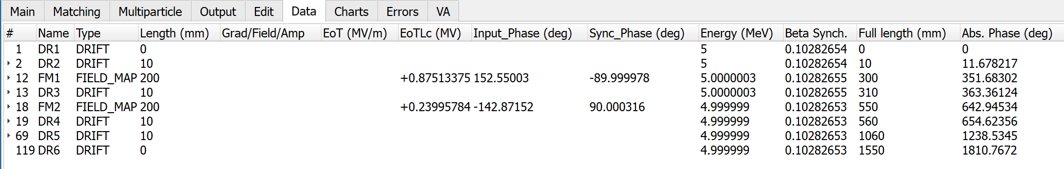

I still have difficulty in understanding the Input_Phase. You have mentioned that:
Referring to the attached snapshots,
When "1", the RF phase of the cavity is 351.68+35.77=387.45
When "0", the RF phase of the cavity is 152.55
They do not match. Could you please explain?
Also, if I have a master clock and I want to determine the phase delay with respect to the master clock in order to achieve the required SYNC_PHASE (as shown in the snapshots), what is the phase delay for the two FIELD_MAPs, FM1 and FM2?
