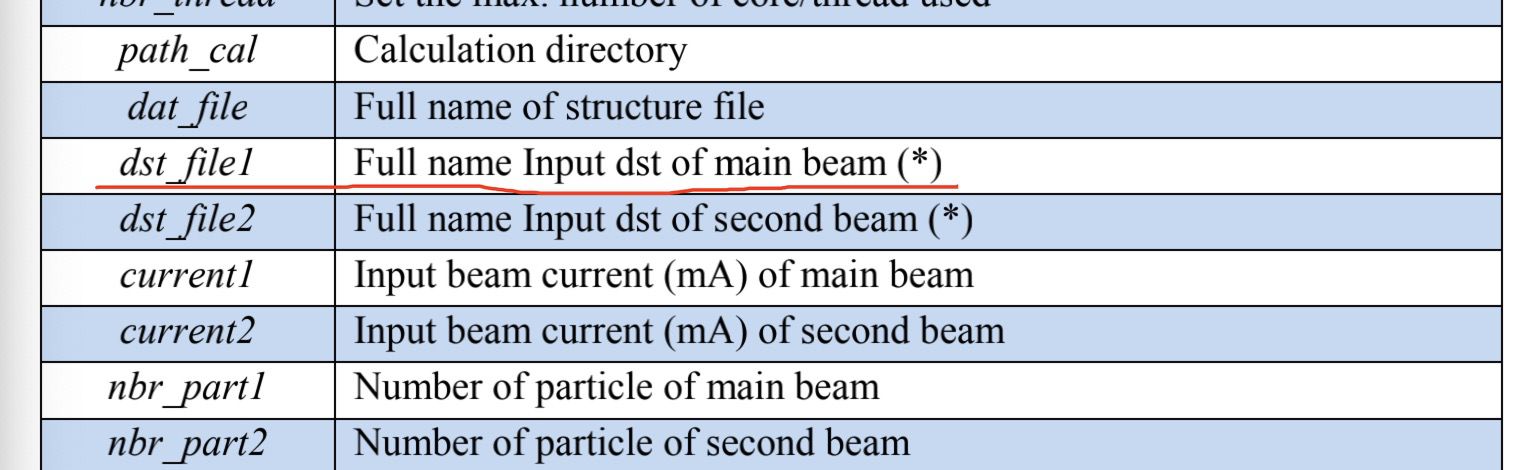

There are relevant operations on page 15 of the Tracewin manual:
page 15 in tracewin manual.jpeg_recompress.jpg (95.11 KiB) Viewed 55414 times

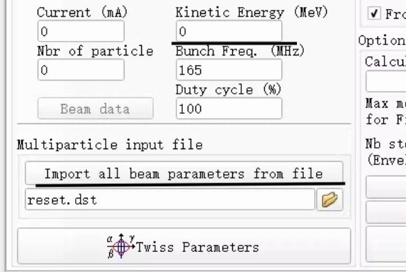

I tried your method, but when I run it in batch mode, it seems that tracewin still cannot read the particle energy from the dst file. (The particle energy in each of my dst files is different)
But When I manually operate, when I click Import all beam parameters from file ,Kinetic Energy parameters can be loaded normally.

1) You read the dst file you want to use and you compute the mean energy of the particles: MeanEnergyCalculated (see the 'GetMeanEnergy' function in the attached python script but I had to change the file extension to ".dat", please replace it by ".py")
2) You change the initial energy of your Tracewin simulation by adding in the command line your are using: "energy1=MeanEnergyCalculated'
Let me know if it works for you.
Nicolas.

In fact, this is not a bug, the behaviour was defined as such for practical reasons. Considering your remarks, I changed the behaviour of the code as follows:
If the dst_filex input is specified, the input beam parameters (number of particle, emittances, Twiss parameters, beam centroid, beam current and energy) are automatically extracted from the specified file and used for the calculation. The emittances and Twiss parameters cannot be modified by the corresponding input commands, but it is still possible for the beam centroid, current, energy, number of particles.
The corresponding new TraceWin version is available.

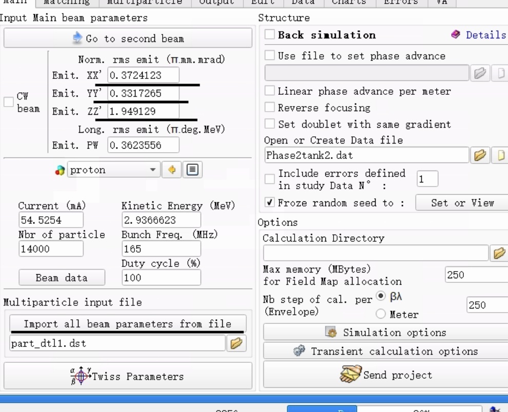

You said If the dst_filex input is specified, the input beam parameters (number of particle, emittances, Twiss parameters, beam centroid, beam current and energy) are automatically extracted from the specified file and used for the calculation。
But in fact, The number of particle, emittances , Twiss parameters, beam centroid and beam current are automatically extracted from the specified file (dst_file)and used for the calculation , but energy not. :shock:

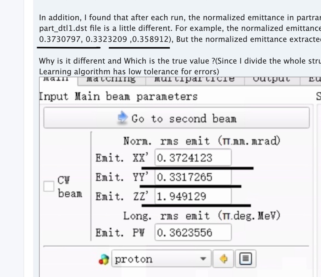

In addition, I found that after each run, the normalized emittance in partran.out file and the normalized emittance extracted from the part_dtl1.dst file is a little different. For example, the normalized emittance(x direction,y direction ,z direction) in partran.out file are( 0.3730797, 0.3323209 ,0.358912), But the normalized emittance extracted from the part_dtl1.dst are (0.3724123 ,0.3317265, 0.3623556),
Why is it different and Which is the true value ?(Since I divide the whole structure into many parts for calculation, and The Deep Reinforcement Learning algorithm has low tolerance for errors)

I maintain that in the latest version of TraceWin (2.18.5.3) the energy used is the one extracted from the dst file when it is specified as an argument with "dst_file1=xxx. This is true unless you also have as argument "energy=xxxx", in which case this latter value will be used.

I don't observe any differences as you mention in your example between the part_dtl1.dst and partran.out. Now using the file "part_dtl1.dst" as an input file as you do is extremely ambiguous and dangerous because it is also the output file of the simulation and there the behaviour is difficult to understand. You have to rename "part_dtl1.dst" before injecting it as input.

Normalized emittance is really different. In my previous example, Emit Xx is 0.3730797 in partran1.out, but in the dst file,the Emit Xx is 0.3724123
