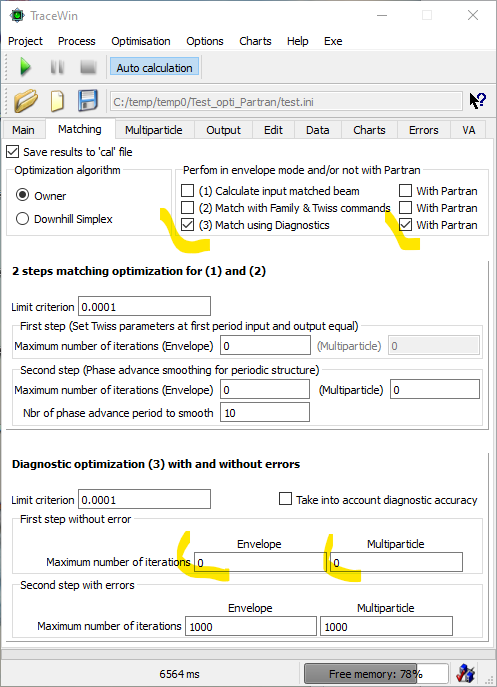

I can only offer you a general solution that cannot be individualized to each matching.
Set the number of iterations to 0 in "Diagnoctic optimization (3)" -> "First step without error" -> "Envelope"

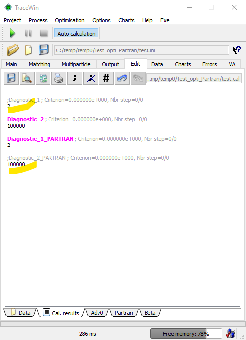

Sorry if I wasn't very clear, below is the procedure to achieve what you are asking for:
First step, I set all optimization numbers of step to 0 and I start a run
You can see, in the result file the envelope and partran matching results but which does not modify the initial values becasue all step are set to 0
Second step, I comment or delete the lines in the result file of what I want to redo.

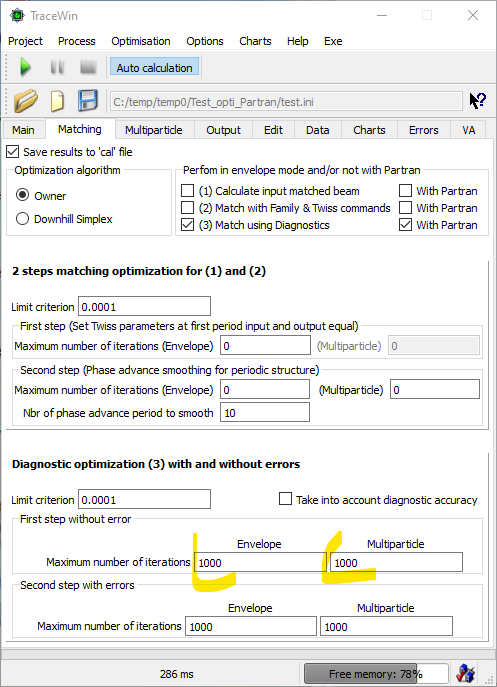

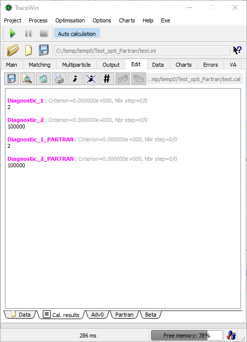

last step, I reset the number of calculation steps to 1000 per Example and start a new run
I hope that it is clearer, if not, do not hesitate to come back here.
