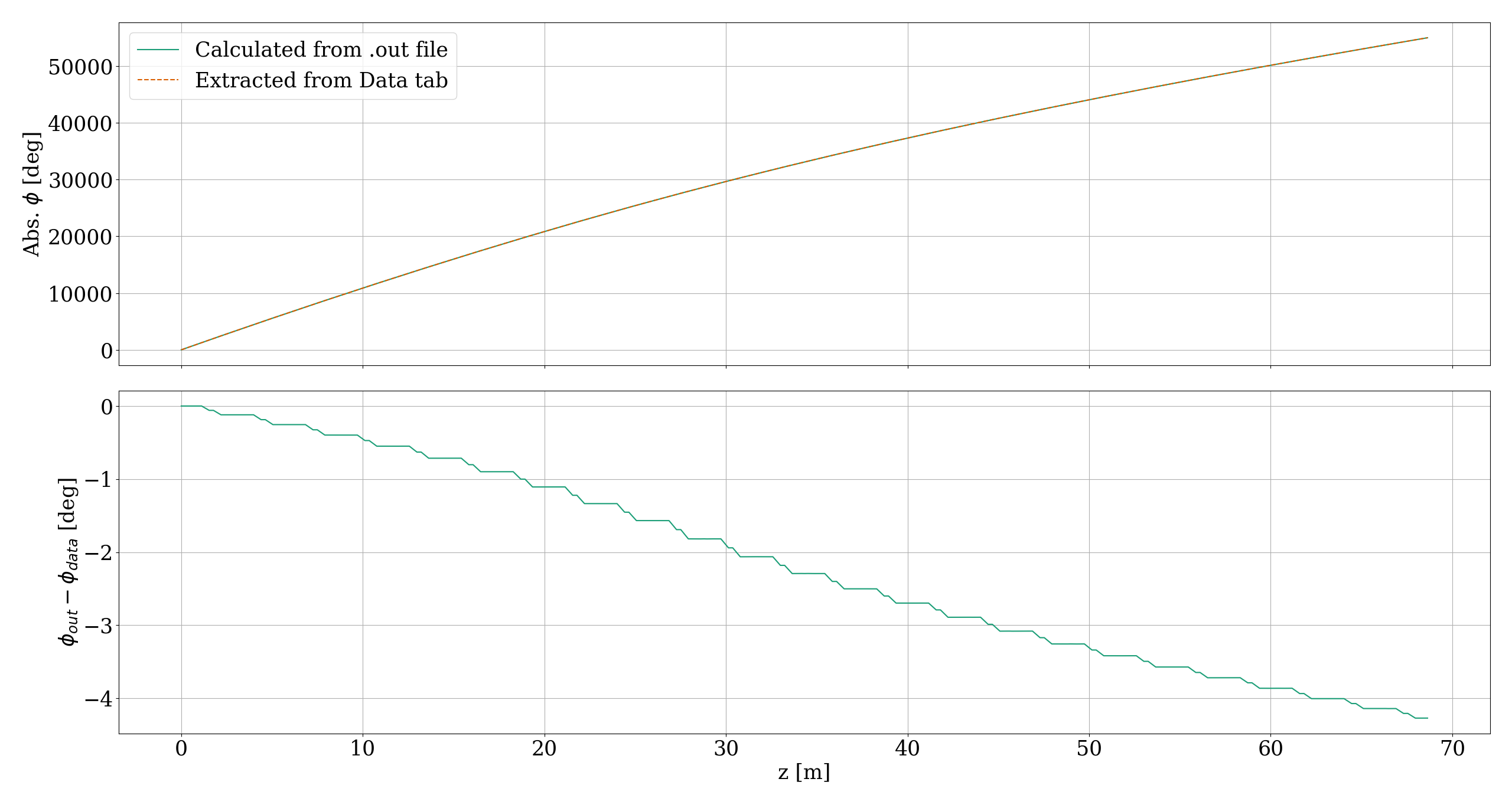

I understand that when the partran1.out and tracewin.out files are saved, their 'resolution' is lowered. When I re-compute some quantities, such as the phase using z (m) and gama-1 columns, I observe a growing error between this phase and the one calculated by TraceWin (e.g. in the .dat file). Increasing the calculation steps would allow me to have more points in the .out, but it would also increase the calculation time.

I am talking about FIELD_MAP simulations.
Here is the phase difference I am talking about:
  • I attached the Python file to compute phase (ΔΦ = ωΔz / (βc)) and produce the figure.
  • The project that I used is from examples: cavity_failure_recovery, but I commented out the ADJUST and ERROR commands.
  • I kept the default 30 steps per βλ
Indeed, the absolute error is very small - I think that the maximum that I ever observed was around 20 degrees, on MYRRHA-ADS linac (250m). I cannot manage to retrieve this version of my project, though.
I retrieve this kind of error with other quantities that I compute from the .out file, such as envelopes or emittances. I am not always sure if it comes from the resolution of the .out file, from a mistake that I made, or if I ran into a corner case. It is particularily important for me to understand what happens when I launch batch runs with an consequent number of simulations (balance simulation time/precision).

Using your example, I looked at the phase calculated directly in TraceWin on the "Data" page and found 54985.648 deg for cal_step=3000 and 54985.458 for cal_step=30. This gives an error of less than 0.0004%. These values are calculated using the calculation step and not the file saving step.
Data from "Data" page can be saved automatically in a file using the "tab_file" argument.

I will now load the "Data" file to systematically check if my phase calculated from .out is close enough to what I should have.
I cannot reproduce a case where phases calculated from .out diverge from the Data table, so I must have overlooked something, sorry for that.
