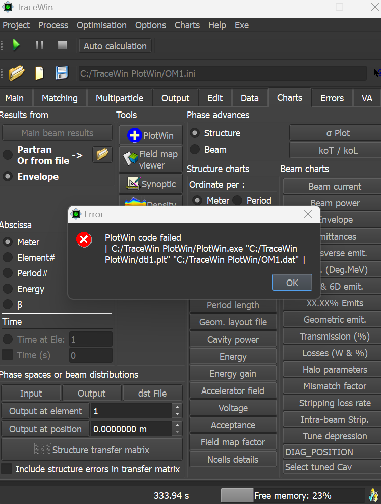

I encountered an issue related to the PlotWin button within the TraceWin environment. Although I searched for information about this error, I couldn't find anything in the official manual or on the forum. Fortunately, I managed to resolve the problem.
Each attempt to use the PlotWin button after a simulation resulted in an error message (please refer to the attached screenshot).
To rectify this, at least in my case on Windows 11, both programs need to be located within a shared directory. Additionally, the directory name or root must not contain any spaces. It's also important to launch PlotWin prior to TraceWin.
I'm unsure whether this is a bug or if I didn't follow the "installation" procedure correctly. However, it might be helpful to mention this issue in the manual or address it in a future update.

Dear Luis,
Ok, I've fixed the problems you pointed out and made a few other improvements, however I didn't see any issue about the shared directory.

Didier wrote: ↑Mon 28 Aug 2023 09:42 Dear Luis,
Thank you. Maybe the shared directory fixes nothing, and it was just by chance that I put them together when I made it work.
