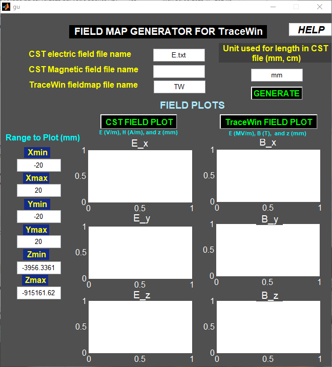

Re: How to use field_map
Posted: Tue 19 Sep 2023 15:40
Dear Abhishek,
Thanks again for all your work, including the video.
Despite all this I'm stuck and I can't view the fields or output a non-empty TraceWin file.
So using the E.txt file provided by Chen, here's what I tried without success, probably I'm wrong somewhere.
Posted: Tue 19 Sep 2023 16:05
by Abhishek
The tool needs both files, that is, the electric and magnetic field map (for RF) files from CST. Here for this case, we can use the same file name in both the boxes ('E.txt') and use the .edz files only.
I also noticed that the z coordinates in 'E.txt' are all <0 and my GUI calculates the z using max(of the z column).
For this file, I would advise using 'E.txt' in both boxes (see attached). and use the TW.edx, TW.edy, and TW.edz.
After the files are generated, Chen needs to change the z lengths in the generated files. I checked for the x and y dimensions, and they are correct.
