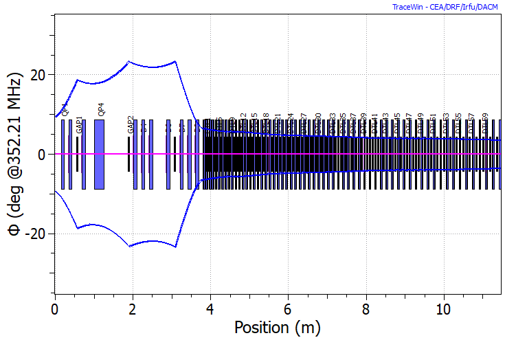

I took a design from the MEBT+DTL of your machine that I had in 2022 and bellow, this is the envelope that I get with the latest version of TraceWin without changing anything in the initial project.
I'm sorry, but I don't know what you're talking about. Please send me a very simplified example illustrating your problem so that I can help you.

Ok thank you for the example, but once again I get the previous plot!
Could you show me the plot you have that you think is wrong?
