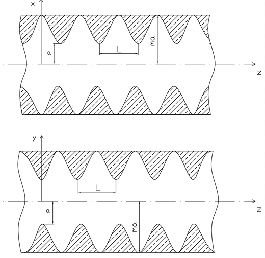

At the toutatis we can define the longitudinal profile error and RF phase error.
1. Does the longitudinal profile error means the error at 'a' at the attached figure?
2. Does the RF phase error corresponding to the error at 'L' at the attached figure?
Best regards
Best regards
RD= Longitudinal profile error will induce a shift between the extrema of an electrode. In other words, minimum a will not be at the same location z than the maximum mxa for the neighboring electrodes. Note that the new GUI for Toutatis 2.0 helps you visualizing the different errors (.inp editor).
RD: No. It is a random error dPhi on V/2 x sin(omaga x t) => V/2 x sin(omaga x t +dPhi) for the polarization of the electrodes. It is more then a way to simulate phase errors with your power supply ou LLRF.

3. Question about longitudinal profile error
Does it means that the value of a is not changed but the the z position for the maximum pole is changed?
4. Question about the field phase error
The RFQ can be think as single cavity so does the random error dphi means that the error of input RF?
Then it looks like the rf phase error set to all of the RFQ cells equally.
Does I correctly understand?

However, there are remained unclear things for me. It is about question 3, 4.
