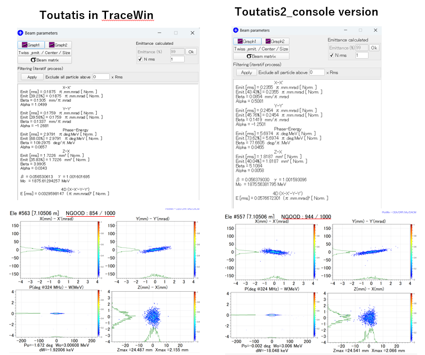

We are currently running simulations using both Toutatis integrated in TraceWin and Toutatis2_console_win64.exe, and are comparing the output results from the two.
We observe discrepancies in the results, for example, in the rms emittances and the beam transmission, as attached (.png). We would expect the two results to agree when the same initial conditions are used.

Re: Discrepancies Between Toutatis in TraceWin and Toutatis2_console Results
I think I have found the main source of the discrepancy. In RFQ_324MHz.inp, you have both:
THE2TERMSFLAG
THE2TERMSFORMULATIONFLAG
The keyword THE2TERMSFLAG means that the code must generate a vane geometry with a modulation profile following the simplified 2 terms potential (sometimes called the ideal potential). But you also add the keyword THE2TERMSFORMULATIONFLAG, in this case the code will not use the finite difference Laplace solver and will use the ideal 2 terms potential instead. This leads to better transmission as no multipoles are considered.
In Tracewin, only the keyword TWOTERMS is used. This is equivalent to using THE2TERMSFLAG only with Toutatis. In this case, the Laplace solver is used and multipoles will be present. Transmission is degraded.
I recommend then that you delete THE2TERMSFORMULATIONFLAG in RFQ_324MHz.inp.
All the best.
