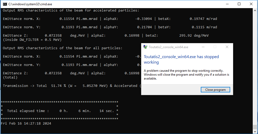

Hi Didier,
It started running with the more no of particles, but it giving some error after completing the run.
error message
error message
. I have to click on the close program, than only it is running the other file.
Re: Running in batch mode
Posted: Fri 16 Feb 2024 11:23
by RomualdDuperrier
I will try to help you. Please share your input files (at least *.inp) in order to reproduce the bug on my platform for investigation.
Posted: Fri 16 Feb 2024 16:35
by RomualdDuperrier
I am embarassed as I can not reproduce the bug on my WIN10 platform. I tried to run from CMD.exe or PowerShell.exe and everything went fine. I will try next week to run on other platforms in case something pops up. Please try to investigate in parallel if they are options on your platform when running the code. I will also to update the executable on the site in case we are running the same version (it should be the case but we never know).
