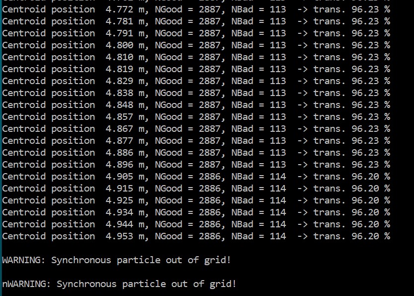

Re: Export error
Posted: Wed 9 Mar 2022 08:00
by Vyacheslav
Dear Romuald,
unfortunately with the fixed files programs cannot perform correct calculations.
Please, look at the attached files. Without fixed files it is obtained fig.1. What is a problem in and how fix it?
Fig. 1
Fig. 1

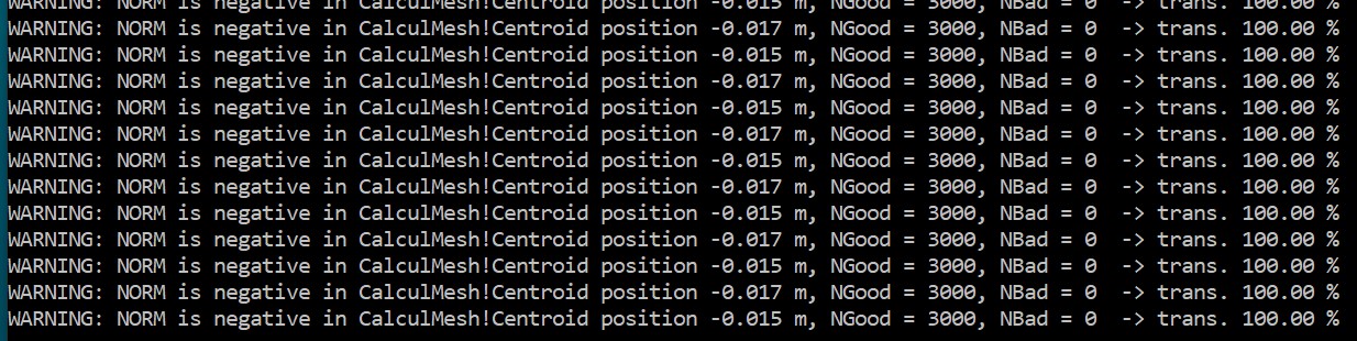

With the fixed files it was obtained the result shown in fig.2.
What can you advise me?
