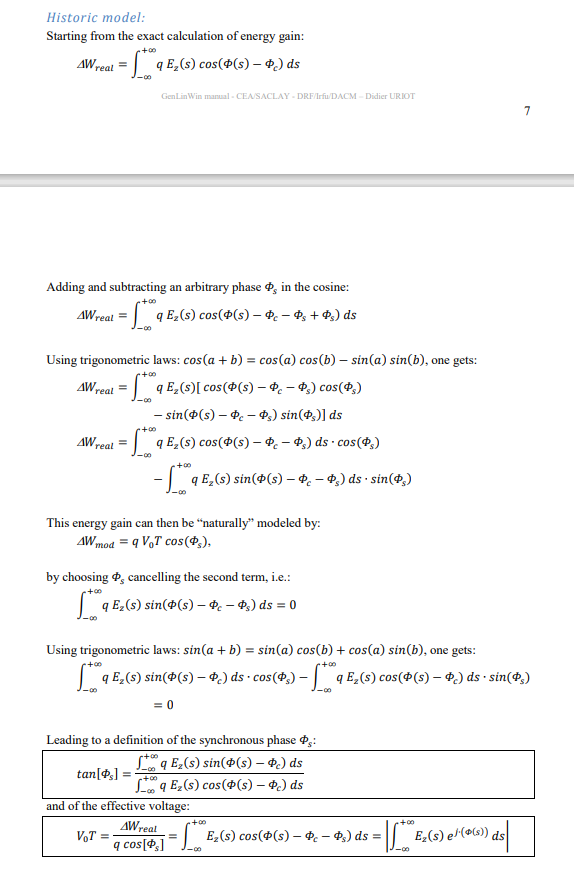

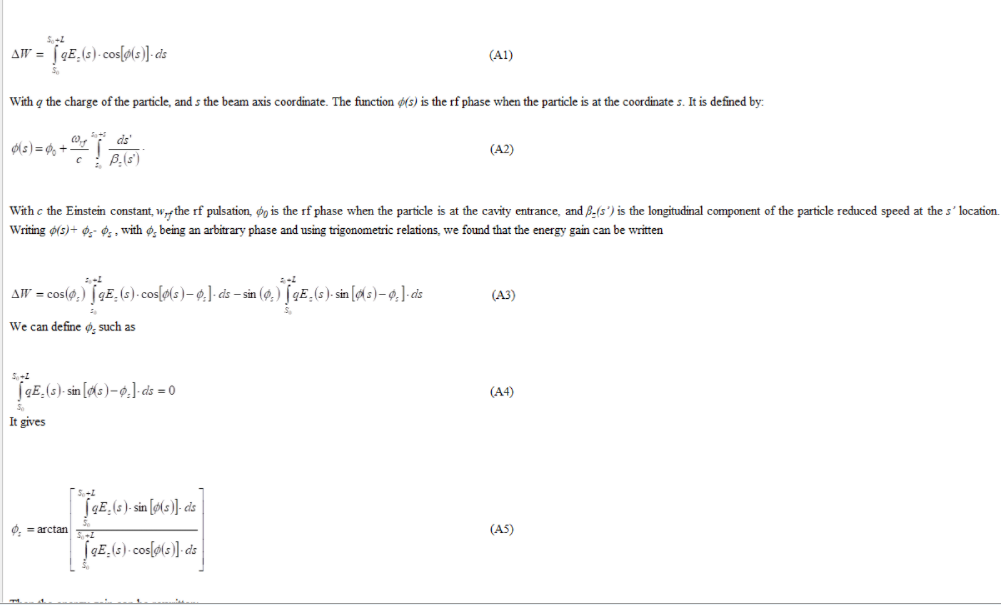

From the previous definition:
With the present one:
I have the next questions:
1) Is Eq.(A.2) remain the same in the updated definition?
2) How is defined the PHI_C (RF phase in the cavity)? (Maybe this is related to the 1 question).

2) With this new notation, PhiC models the RF phase in the cavity ( PhiC changes by by 1° when the RF field is changes by 1°).
As you can see, by arbitrary definition, -PhiC is the RF phase when Phi(s) = 0 (or the RF phase is 0 when Phi(s)=PhiC).
In the former definition, "Phi(s)" was the RF seen by the particle when at s.
Now, "Phi(s) - PhiC" is the RF seen by the particle when at s.
1) YES, equation (A2) remains the same, considering the phase of the RF field seen by the particle.
With the new notation, this field is written "Phi(s) - PhiC".
Whatever the way the synchronous phase is defined (with or without PhiC), the particle dynamics is always calculated withthe RF field seen by the particle.
