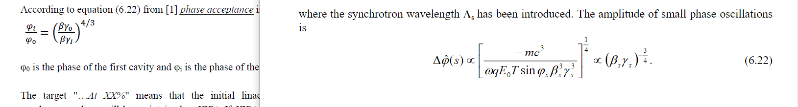

About the equation for the phase acceptance, I think that the exponent is 3/4 instead of 4/3.
According to the reference
Is that correct?
Thanks for your help and support,
Re: Longitudinal phase advance
Posted: Fri 22 Oct 2021 11:22
Phase advance is calculated using the transfer matrix (replace xx' by zz')
For the second point, you're rigth, it's done like this, it's a typo in the manual. I'll fix it.

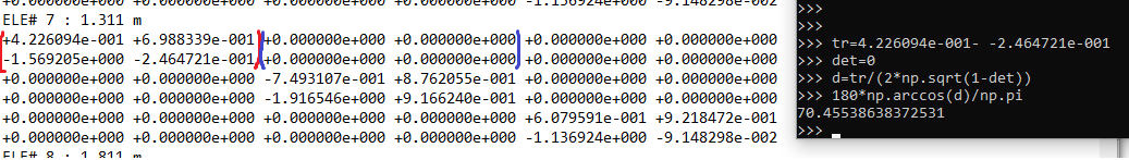

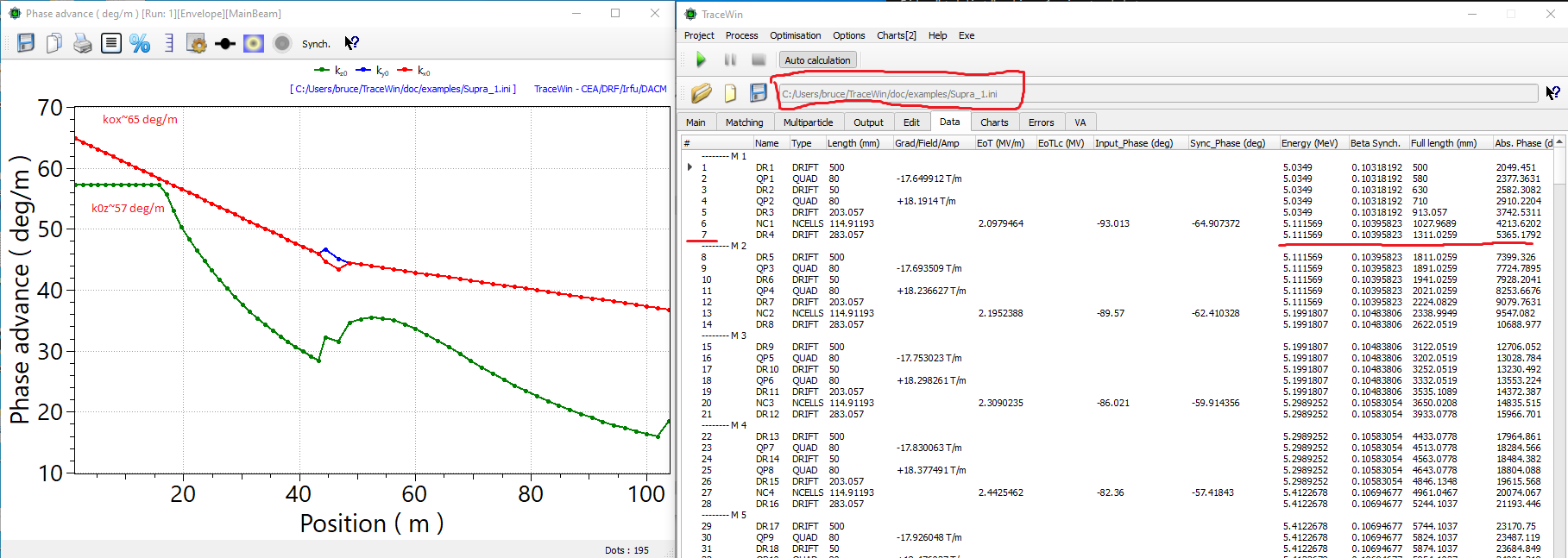

I computed Ko's according to that formula.
As an example, I tested in the supra_1 example, given in the Example folder of TraceWin.
I used the values of the transfer matrix for element 7 (the last element in the period) to compute K0z.
The variable "det"=0 . The value is different from the 57 deg/m shown in the chart.

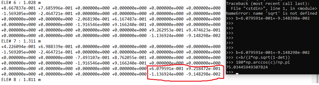

Similarly, I computed kox,
In that case, the value is also different from the one shown in the chart.

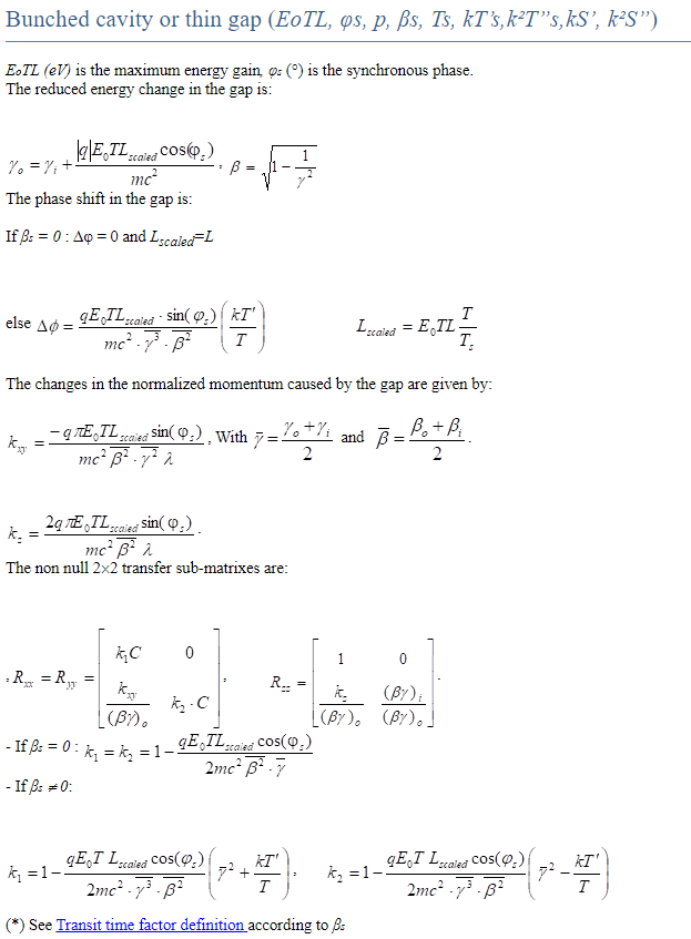

Which is the matrix representation for an RF cavity for a field map in TraceWin?
I found in the Manual the matrix for a bunched cavity. However, I could not find the matrix for an RF cavity for a field map in TraceWin.
Again, thanks for the help and support.
Posted: Wed 27 Oct 2021 15:41
For the field map, there is no specific way to simulate an RF gap or the like. This is a general approach described in the chapter "Particle Motion in the Electromagnetic Field".
