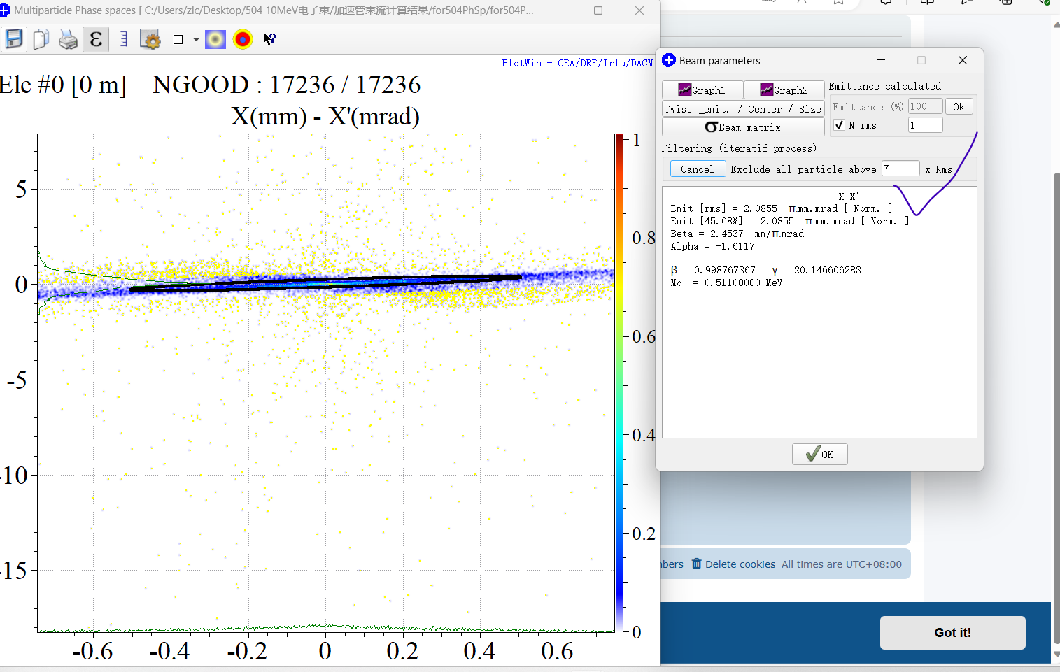

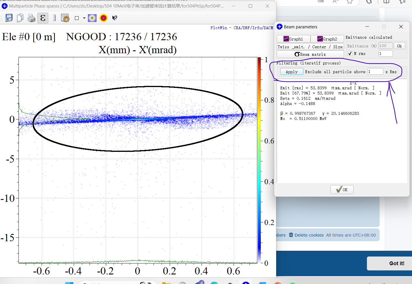

In the beam parameter page, one can choose using filter or not to abandon the halo particles.
My question is how does it work? If we set "exclude all particles above 4xRMS', what does it mean? How many particles are abandoned?
Filter exclude particles above xRMS

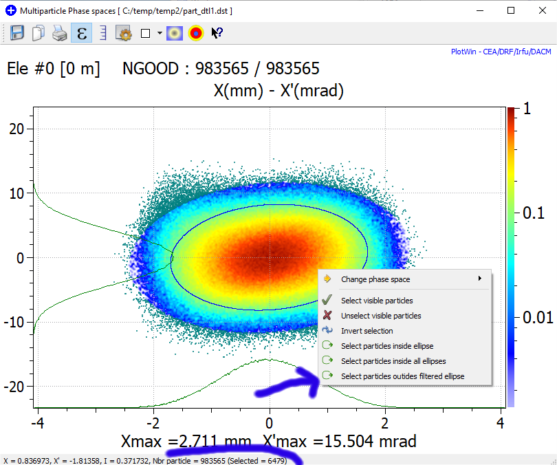

Can we know the final number of particles excluded or included? Like 'select visible particles ', the particle number is shown below the figure.
Re: Filter exclude particles above xRMS
Dear Zhao,
I added in particle distribution plot the possibilité to select particle outside elipse calculated with filtered methode and also then number of selected particle is now print at the bottom of the windows (see bellow)
