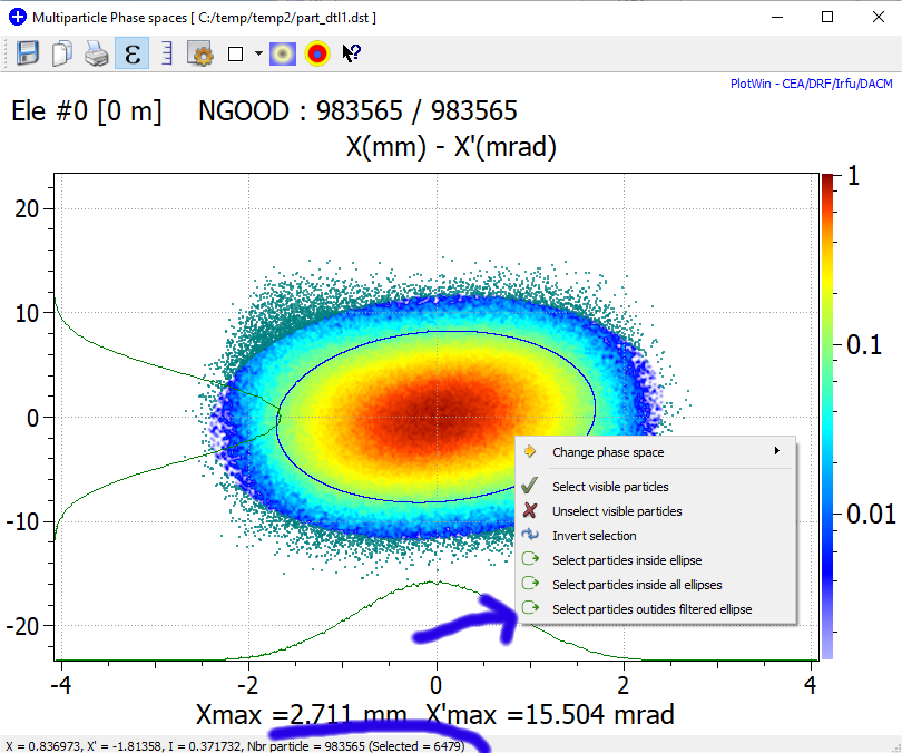

Can we know the final number of particles excluded or included? Like 'select visible particles ', the particle number is shown below the figure.
Re: Filter exclude particles above xRMS
Posted: Mon 22 Jan 2024 11:19
Dear Zhao,
I added in particle distribution plot the possibilité to select particle outside elipse calculated with filtered methode and also then number of selected particle is now print at the bottom of the windows (see bellow)
