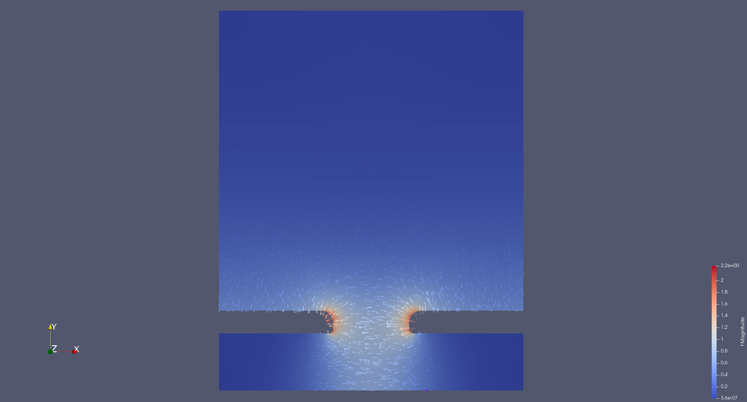

Thank you again. Since the electric field is calculated cell by cell, can the electric field in the gap within a cell be solved using electrostatic method? For example, for Alvarez DTL, Dirichlet boundary conditions are set at both ends of the cell (at the center of DT), and the Laplace equation of the electric potential is solved using finite element method. The geometry is like this:
Warson

Dear Warson,
Sorry, I'm not at all RF expert, have a look on the SuperFish manual to see the detailed method of the solver.
