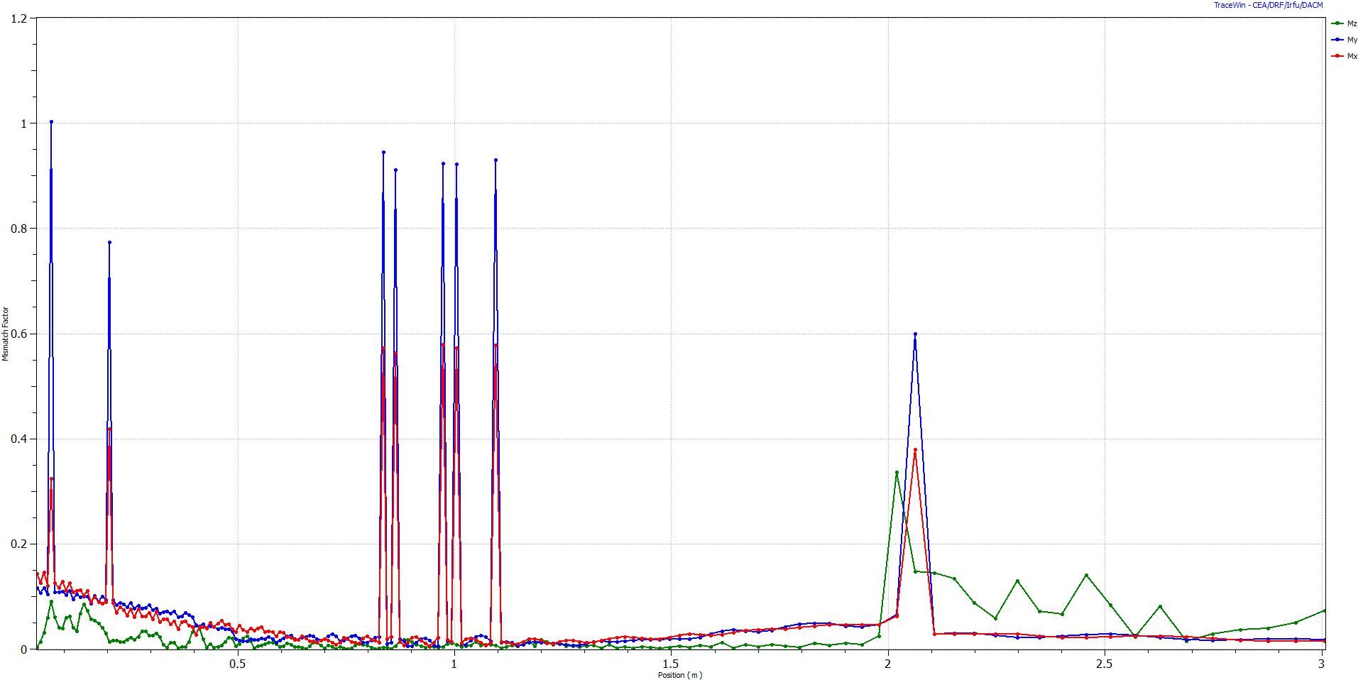

Please see the attached figure. If mismatch factor is 1% -> βx are multiplied by 1.01² means that transverse size is 1% bigger, Please suggest me if its correct or not ?
- Mismatch.jpg (137.75 KiB) Viewed 400142 times
