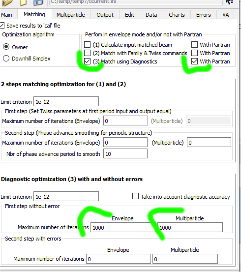

What is the usage of DIAG_DCURRENT? It does not work as I expected. Please see attached project. I expected the optimization will increase the solenoid strength until transmission is 100%. Thank you.

I have attached your project with the correct options. Most of the necessary ones were not even selected. Honestly, using the mauel or the examples given on the matching topic, you could have put it in.
Also very important for this type of transmission optimization, I increased the number of particles to 100.000 because otherwise the transmission accuracy is too low to allow the alogrithm to converge correctly.

It was a careless mistake I had. I started the project new and the "Maximum number of iterations" was defaulted to "0". I overlooked it.
