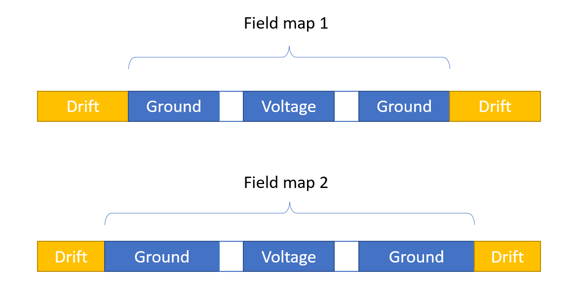

I am aware of the "absolute phase" column in the data tab. It gives the absolute phase when the reference ion is at the beginning and at the end of an element. My problem is that with a field map, I can make it arbitrarily long. Please see fieldmap.PNG. The two models have identical physics. But the absolute phase I can read from the Data tab are different. I want to know that from a control system point of view, what is the phase offset between the two "cavities".

I agree that despite the different lengths the physics is the same and therefore the RF phase shift betwwen cavities must be the same. As you have indicated in the FIELD_MAP statement working in absolute phase and not relative, the offset to be imposed on the RF of the control command is directly the input phase (-3.137° and 157.86°). So the RF phase shift to apply between the cavities is the difference between these two values.
This is my first impression, now having worked extensively on the tuning of the cavities of SPIRAL2 for example, I know that all this is finally quite complex and I may be making a mistake in reasoning.

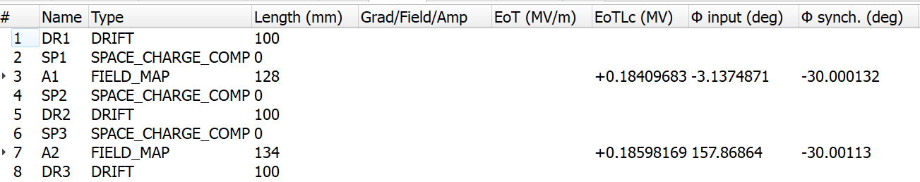

A follow up question on sign convention.
In this example, the phase offset is 157.87-(-3.14)=161.01. Is A1 or A2 leading? Could you also point me to the manual where it discusses the sign convention?
- Capture.PNG (22.43 KiB) Viewed 121283 times

Dear Nicolas,
Thank you very much! It is absolutely very helpful.
Question 1:
E = E0 cos(phi) = E0 cos(360°*f_rf*t+phi0)
In the definition above, it is a "+" sign in front of phi0. So is it correct that in my example, A1 is leading A2 by 157.87-(-3.14)=161.01?
