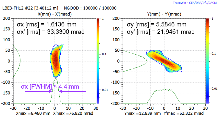

I would like to ask if you could add a functionality in TraceWin.
Lately, I am using often the FWHM beam size to define the resolution of separating two beams with different mass-to-charge ratios.
Until now, I have been using the RMS size definition in the optimization and then I was extracting manually (and not very precise) the FWHM from the size projection in the 'Multiparticle phase space' plots (as shown in the plot).
However, with larger space charge and high order aberrations the particle distribution becomes skewed due to the tails and the results of the optimization are not predictable, i.e. it is difficult to predict what RMS size corresponds to the desired FWHM resolution.
Would it be easy to include the FWHM size definition into the DIAG_SIZE range of diagnostic elements? DIAG_SIZE50?
It would be great also to have the possibility to extract the FWHM size directly from the 'Beam parameters' window of the 'Multiparticle phase space' plots.

Dear Emil,
I'm sorry to have taken so long to reply, but in the end your request wasn't as simple as that to implement and I'll probably have to do a lot of tests to fully validate this new development, and I haven't had the time to do them all.
That said, so, I've added the calcul of the full width at half-maximum (FWHM). Results are visibled in the emit. box of the beam distribution plots and in the "PAR_diag1.dat" file.
I'av add also 3 new diagnostics, BEAM_SIZE_FWHM, BEAM_DSIZE_FWHM, BEAM_DSIZE2_FWHM (see manual for details)

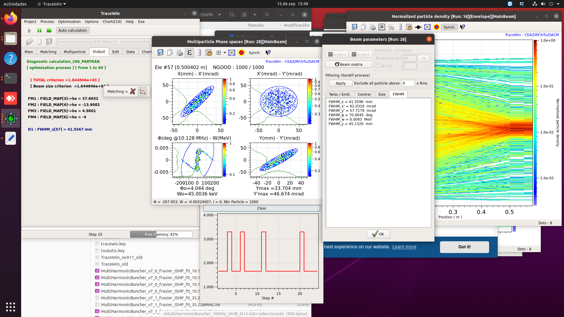

I am trying to use this functionality to adjust the fieldmap amplitudes of a MultiHarmonic buncher, thus I am trying to minimize the "Wanted FHHM Phase spread (°)" at a certain location ~0.5m.
For that I am using the DIAG_SIZE_FWHM command, like this:
but looking at the output message, it seems it is trying to optimize the FWHM_x parameter, am I messing with the syntax or is there a bug?
kind regards!

Re: FWHM size in TraceWin optimization and output
Dear Ibon,
The rigth syntacx is following: "DIAG_SIZE_FWHM 200 0 0 0.5", I think there's some confusion with accuracy parameters.
Secondly, in envelope mode, it won't work because you're in CW mode, so select also matching "With partran"

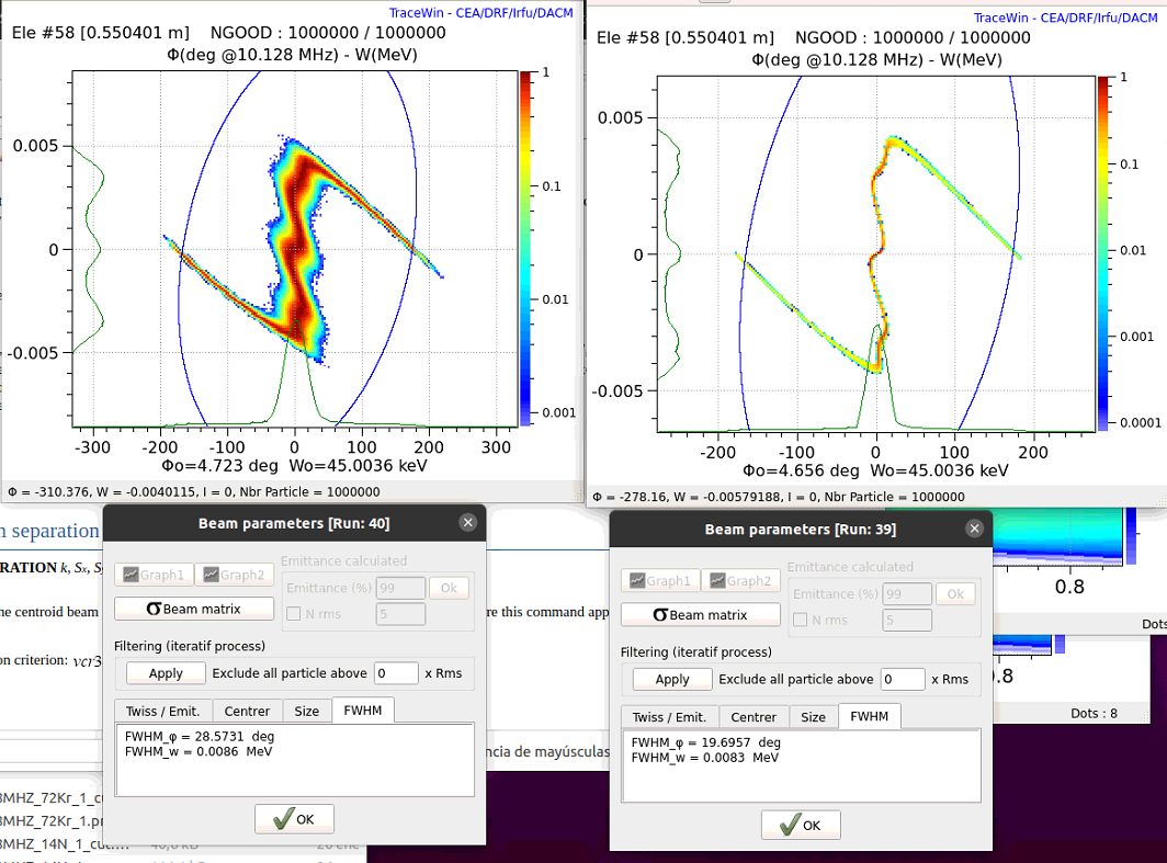

BUT I am not sure about the CW mode comment, since this is MHB, is a device to be used at the 'LEBT' before the RFQ I was assuming CW mode was the correct way. Should I tick the CW box or not?, both seem to work which one is more accurate? in the attached picture I am showing both cases: CW mode ticked (left), not ticked (right)
kind regards!
Many Thanks!, it definitely was a confusion with the accuracy parametersThe rigth syntacx is following: "DIAG_SIZE_FWHM 200 0 0 0.5", I think there's some confusion with accuracy parameters.
The latter part Yes, I was using «matching using Diagnostics with Partran», I am afraid I did attach an intermediate 'try & error' version.Secondly, in envelope mode, it won't work because you're in CW mode, so select also matching "With partran"
kind regards!
Dear Ibon,
Clearly, I'll be using CW mode, as it's the most coherent in my opinion.
