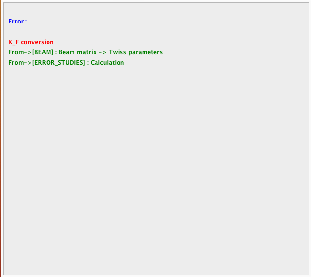

For the error study of the attached project in zip, I have the following error of "K_F conversion":
Screenshot 2023-10-13 at 2.51.45 PM.png (25.47 KiB) Viewed 22353 times
Could you kindly advice what could be wrong? A few observations:
- The project is for partran and with the option of "Match using Diagnostics". There was no issue for running the project with just envelope. Also no issue for partran without the "Match using Diagnostics".
- The error depended on the lattice. The project included lat_good.dat and lat_bad.dat. The issue was observed only for the latter (which includes our MEBT).
/Ryoichi

Posts: 1367
Re: "K_F conversion" error for an error study  [SOLVED]
Dear Ryoichi,
This has now been fixed and I think the bug probably had larger consequences than the problem mentioned here.

I checked with the latest version and seems working now. Thanks for a prompt response as usual.
