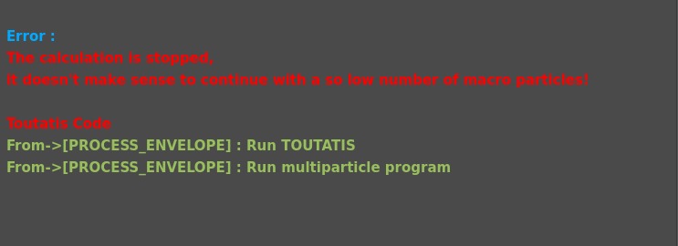

I perform an rfq simulation in tracewin for proton beam and I always get an error. The error message is attached.
The rfq length is almost 3.2 meter. When running simulation until 1.8 meter centroid position there is no problem even transmission is almost 99.7%. But suddenly the simulation is stopped and I got this error message.
Also I attached the input file that I worked on.
Could you check it please what is wrong there ?

Error in rfq simulation

- 1696306970090.jpg (17.66 KiB) Viewed 10778 times

Re: Error in rfq simulation
Dear Emre,
I don't know why, probably a problem in the geometry of your cells, your beam stalls in ernergy. The DW_FILTER variable set to 0.5 is no longer sufficient, so all your particles are filtered and lost. Increasing this limit is fine, but obviously doesn't correct your structural design problem.
