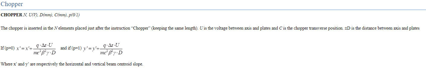

I am doing chopper simulation, and I would like to confirm some details about the definition in TraceWin.
According to the manual, the chopper is defined as

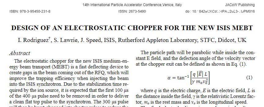

I compared it with other definitions in the literature:
Chopper definition.png (59.43 KiB) Viewed 10285 times
in this case E= V/d

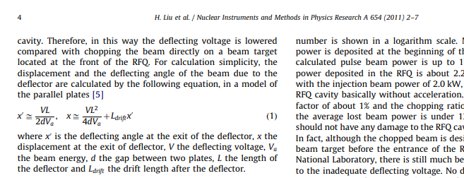

Chopper definition_2.png (94.12 KiB) Viewed 10285 times
in this case Va= 1/2 *mo gama * vo^2
The definitions are similar, but the other cases use the distance between plates as "d" or "D". However, TraceWin uses "D" as the distance between the plates and the axis.
In that case, there is a factor of 2 in the denominator that appears in the other cases, but not in TraceWin. Could you please tell me the difference?

I've already noticed this factor of 2 depending on the publications and I think that sometimes it comes from confusion between the distance of the plates from the axis or between the plates, it's not always very clear.
However, for me, voltage and distance are from the 0 axis, so E=U/D and to convince myself, I'll compare it with an equivalent electrostatic field map, like follwing exemple:

Both give the same deviation, so I have no doubts about the CHOPPER element.
Concerning the 'C' parameter, it's just a deviation in the transverse direction of the position of the plates, so it won't have any effect in envelope mode because the field remains the same, but it will generate losses in tracking mode in your case, since one of the plates is 120 mm from the axis and the other is on the beam axis. In general, the two plates are slightly offset in the direction of deflection (few mm) to prevent the deflected beam from impacting one of the plates towards the exit.
