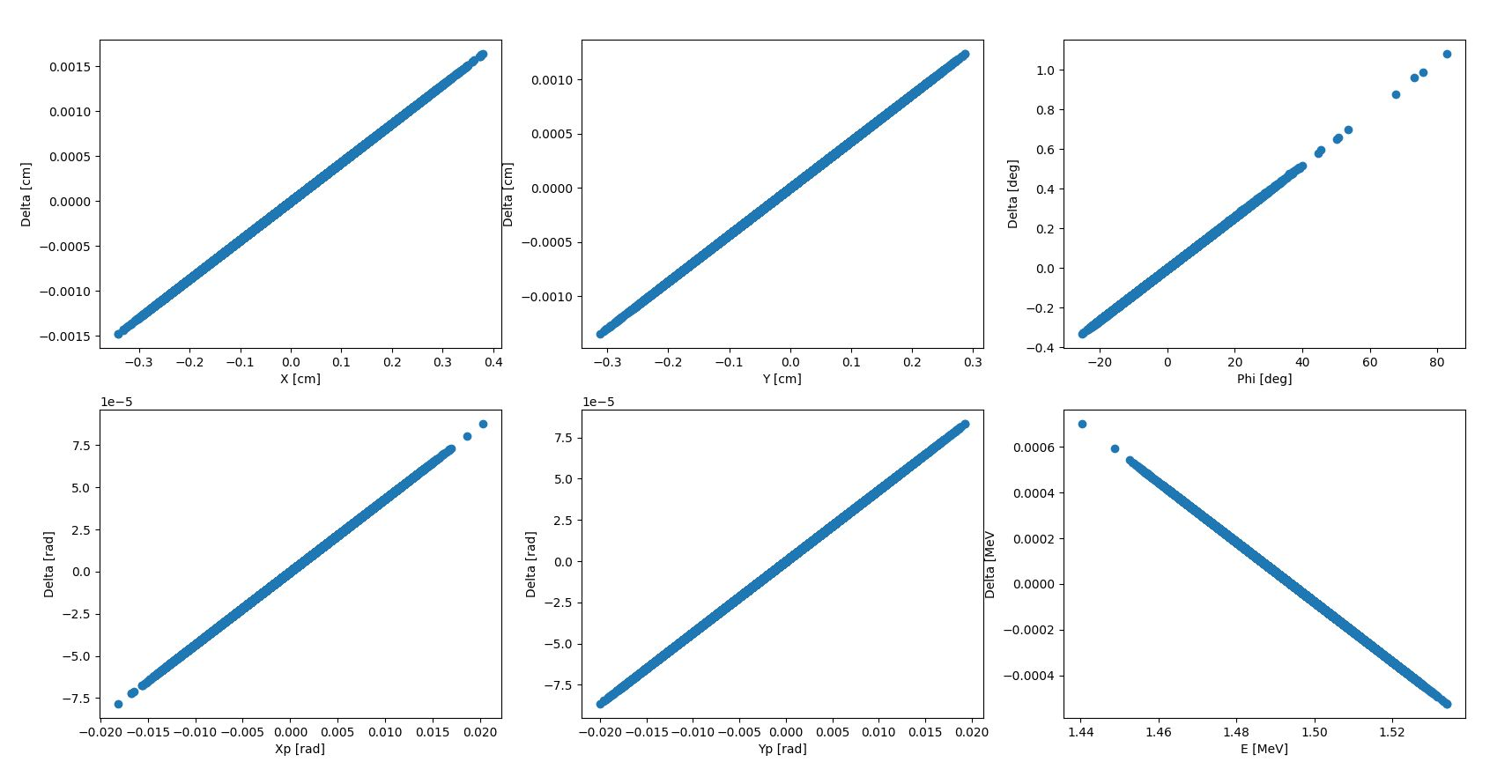

Hi Didier,
when running TraceWin through the GUI and with TraceWin_noX11, I noticed subtle differences in the input distributions saved to the plt-file.
Between the two, it looks like there is a linear scaling applied (see picture in the attachment showing the delta as a function of the parameter values).
Is this a bug or is there a simple explanation?

Re: input distributions plt-file different for TraceWin and TraceWin_noX11
Hi Didier,
you can find .zip file in the attachment.
For the noX11 run I used the following commandline prompt:
'TraceWin_noX11 i1lb.ini path_cal=output_cmd partran=1 nbr_part1=535332 use_dst_file dst_file1=RFQ_exit_acc_centered.dst energy1=1.494 cancel_matchingp'
Be aware that in this particular case, the input reference energy of the beam was purposely lowered from 1.52 MeV (taken from the distribution file) to 1.494 MeV. Could it be related to this?
P.s.: I just did the check myself and indeed it's related to the energy shift. without the shift and leaving the energy as is (1.52 MeV) the results are identical.
Re: input distributions plt-file different for TraceWin and TraceWin_noX11 [SOLVED]
Dear Lennert,
It's fixed, please upgrade your code.
I can confirm that the issue is resolved with the latest upgrade. Thanks a lot!
