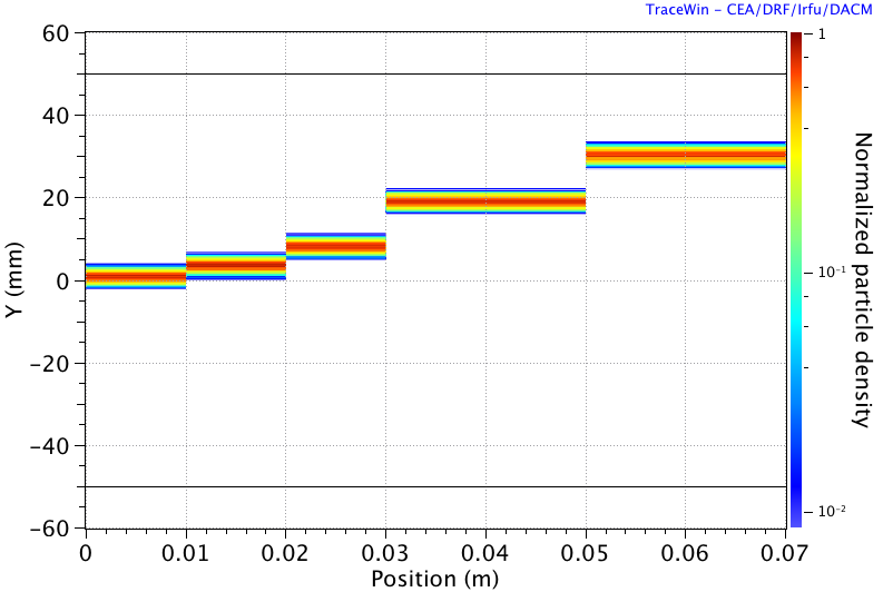

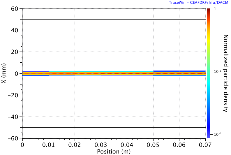

I found a strange behavior of the SHIFT command. Please find that a very simple sample project is attached. In short, the command seems applying a very large shift in vertical plane, even to the preceding element, as seen in the also attached density plots. (In the other plane, either the issue doesn't exist or much smaller compared to the vertical plane).
The version I tested was the latest 2.24.2.0 for Mac and Linux. (When I tested with a very old version of 2.23.4.5, I didn't find this issue.)
