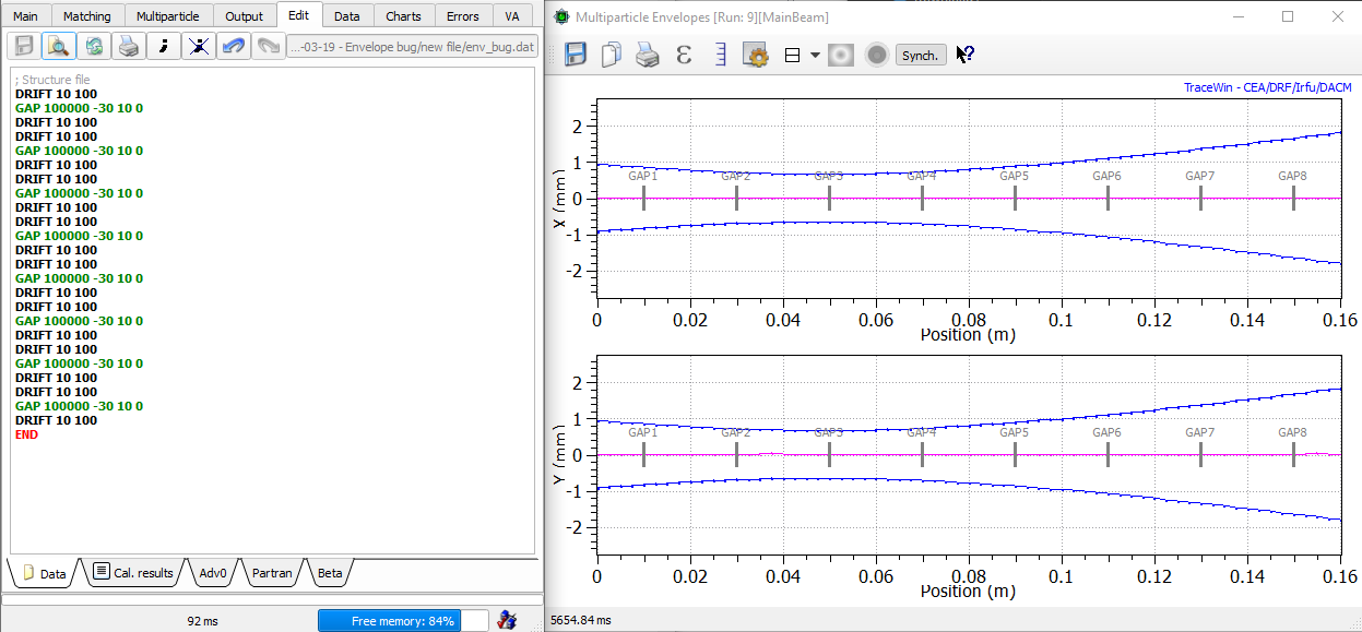

I think I found a bug in the newest TraceWin Version (2.16.6.13).

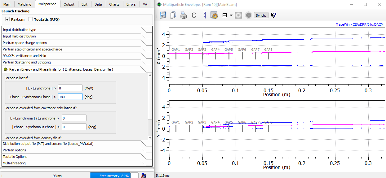

If I set Phase and Energy limits under "Multiparticle"->"Partran Energy and Phase limits ..."->"Particle is lost if:", the multiparticle envelope plots seem to be broken.
After encountering this in a project file, I tested on 2 PCs with a simple example file. An older Version did not show this behaviour (tested 2.16.6.6).
Normal behaviour without limits:
Broken with limits:
Hendrik

Dear Hendrik,
It's fixed, please dwonload new version.
