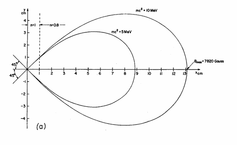

I am simulating the 90 ° deflection of the particles in the alpha magnet. The particles should have been injected from the origin at an angle of 45 ° and then returned to the origin at 45 °. However, I found that the particles did not seem to complete a complete trajectory, which ended at nearly half of the time, so I only put in the upper half of the magnetic field. Is this complete trajectory feasible ? Now I want to get the trajectory length of the particles, so I only simulated half. Because I am unfamiliar with the software, the parameters I set may be wrong, thank you very much for your correction. What I want is that the particles are injected at an angle of 45 ° in the zy plane, and the magnetic field is an electrostatic field.
cyrus
cyrus
