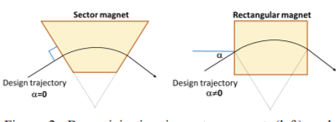

I would like to simulate a sector bending magnet (the angle of the beam with the dipole face is 90 deg) as shown on the left side of the
next figure.

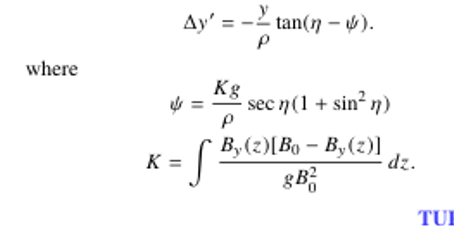

For K1, I find the next relationship:
Could you please tell me how to compute those contributions?

No, it's a rectangular magnet. You can use Synoptic tool to visualise that.
And for K1 & K2, it's notice in manual

Thanks for the manual reference. One question, for the text in the manual "K1 and K2 are used in a development for the fringe-field correction. If they are equal to zero, K1 = 0.45 and K2 = 2.8." , I understand that for the case that fringe-field correction is zero K1=0.45 and K2=2.8. Is that correct?
Nevertheless, it does not mentioned how is computed K1 and K2, it shows how this compensated in the matrix. Am I correct?
Thanks for your time.

If you don't want to take fringe-field correction into account, set k1 & k2 to 1e-12, but not to 0.

I've noticed that the horizontal envelope is the same, but the vertical has the same peak locations, but the size is smaller (TraceWin is smaller). So, I am guessing that difference between the two codes is in the fringe field compensation on the vertical axis, which is why I was inquiring about how to compute K1 and K2.
