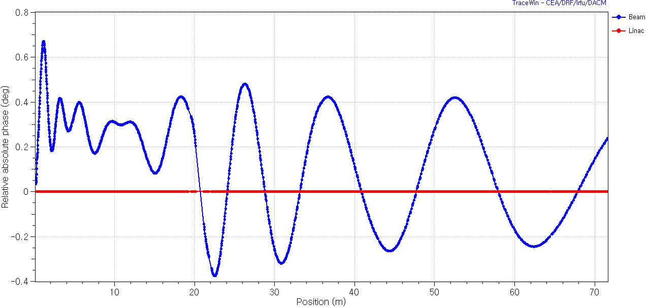

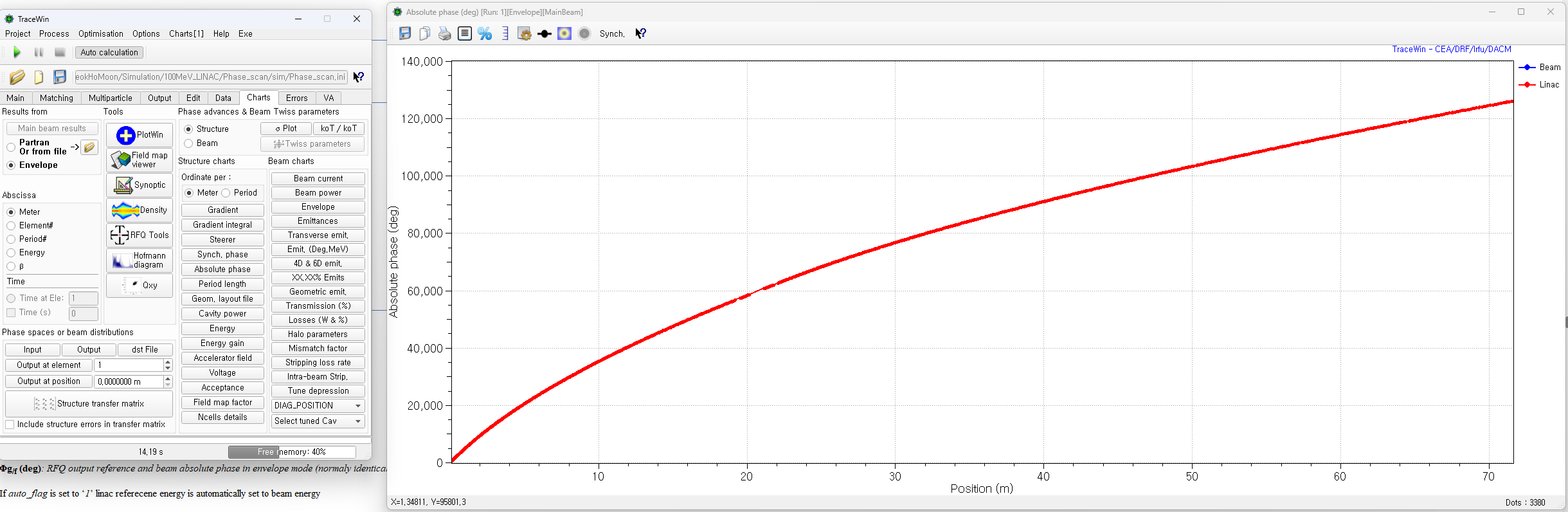

Question 1. Definition of relative absolute phase
When I plot the absolute phase with envelope result, I see the figure like "Beam_Phase.png" However, if I plot the absolute phase with partran result, I see the figure like "Relative_absolute_phase.jpg". The calculated beam phase may be slightly different when we compare the multi-particle simulation and envelope simulation. Then, those the variation at "Relative_absolute_phase.jpg" means the difference between multi-particle simulation and envelope simulation?
Question 2. How can I get the data at "Relative_absolute_phase.jpg" automatically.
When I check the data at "Density_PAR.dat" and "Density_Env.dat". The "phaseF" and "phaseG" are perfectly same and those data is also perfectly match with data at "Beam_Phase.png". Then, is there any other way to get the data at "Relative_absolute_phase.jpg" automatically?
I also check the partran.out file and see the "delta phiS" which corresponding to "average beam phase"- "reference beam phase" but the data is also no matched.
Question 3. Definition of "delta phiS" at partran.out file
At partran.out file we can see that data "delta phiS" which corresponding to "average beam phase"- "reference beam phase". It looks like "average beam phase" is the average of phase in the particle distribution and "reference beam phase" is same with absolute phase at "Beam_phase.png" Am I right?
Best regards
SeokHo Moon
Re: Question about beam phase and output file
Dear SeokHo,
1 - Yes, "Relative_absolute_phase.jpg" means the difference between multi-particle simulation and envelope simulation.
2 - In the file “partran.out”, it is the column “p0”.
3 - yes you're right
I don't know what you try to do exactly, but perhpas the command "TUNE_CAVITY" could be usuful for you.
