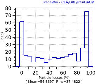

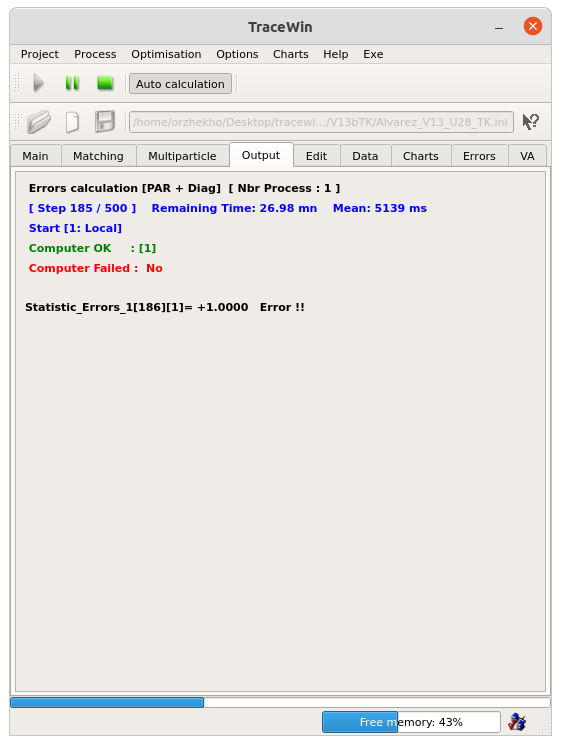

during last error study I saw quite often at output screen the line ... [N][1]=+1.000 Error!!!
It is changed is some seconds with the typical report about current N-th run (see pics).
In parallel, the historgam for the losses is sometimes a bit strange, see the plot. I would expect it more Gaussian. At the example I have just a quadrupole displacement dx, dy.
Maybe the errors are now chosen not so uniformly?

Re: Errors choice
Dear Anna,
Error message could come because you have lost all your beam (see message log in "Computer box").
For the rest, please send me your project files, otherwise it's complicated for me, to explain the shape of your curve.
