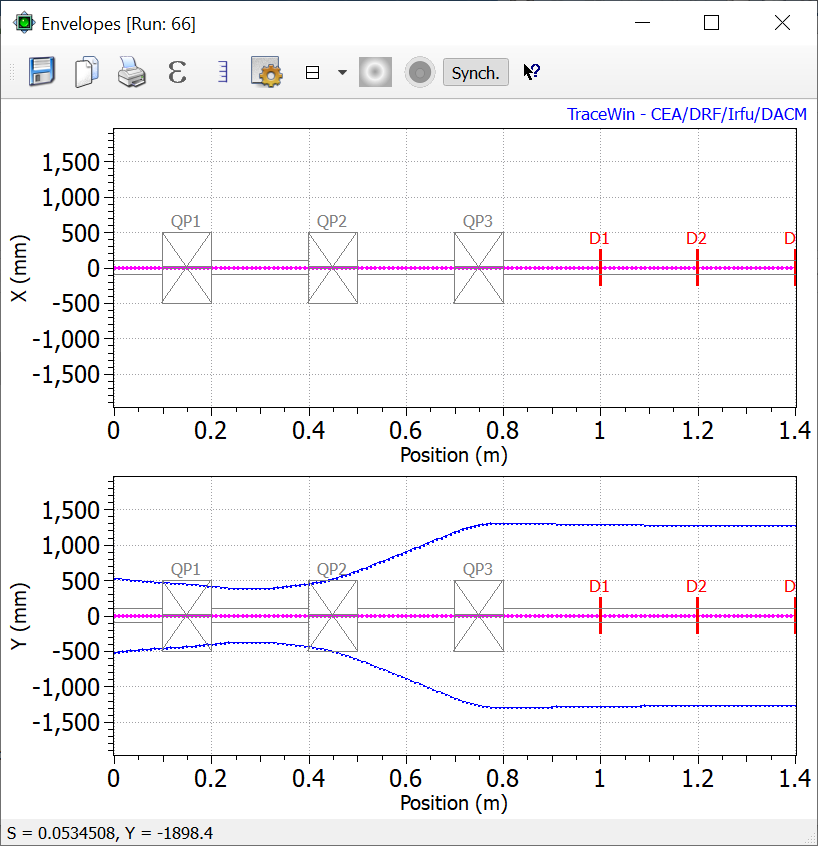

Please find the .ini file and the envelope plot attached.

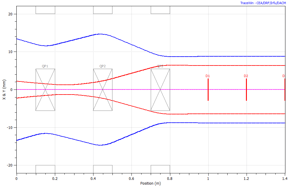

I'm sorry, but I don't understand exactly what you are simulating. Using your file I still have the envelope below, very similar as my first answer and perfectly working. So, I have attached the complete project here (*.ini, *.dat, *.cal).

I tried your input files in a new folder and they worked just like you described. Then I compared them to my input files (in another folder) and could not find any differences, but the problem was still there, i.e. huge emittance in one plane. However, the problem went away when I deleted all other files except the .ini and .dat (structure files) and started over with the matching. So perhaps I had some left-over file in my original folder throwing off the matching routine?
