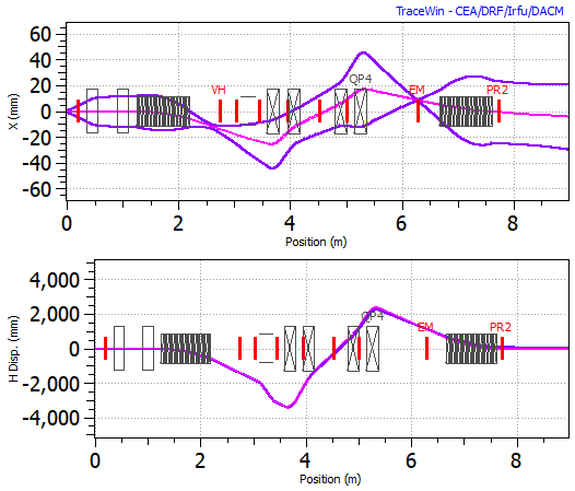

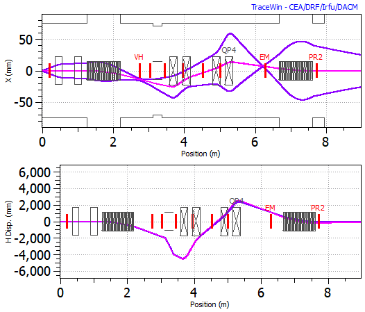

I opened a project in TraceWin 2.17.1.7, which I have created with an older version (2.16.6.1).
Apparently, the dispersion is calculated differently in the two versions (in envelope mode).
In the older version I had reached achromaticity whereas with the newer version this is not the case.
I have opened the same saved project and I get the same transverse envelopes but I get different results for dispersion.
It seems that the difference originates at the ELECTROSTA_ACC element.
Here are the two plots.
New TraceWin version:
Older TraceWin version:
The project files are attached too.
Could you tell me what is the reason and which version makes the correct calculation, please?

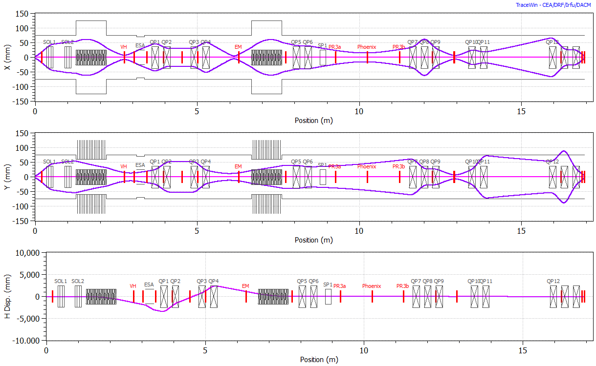

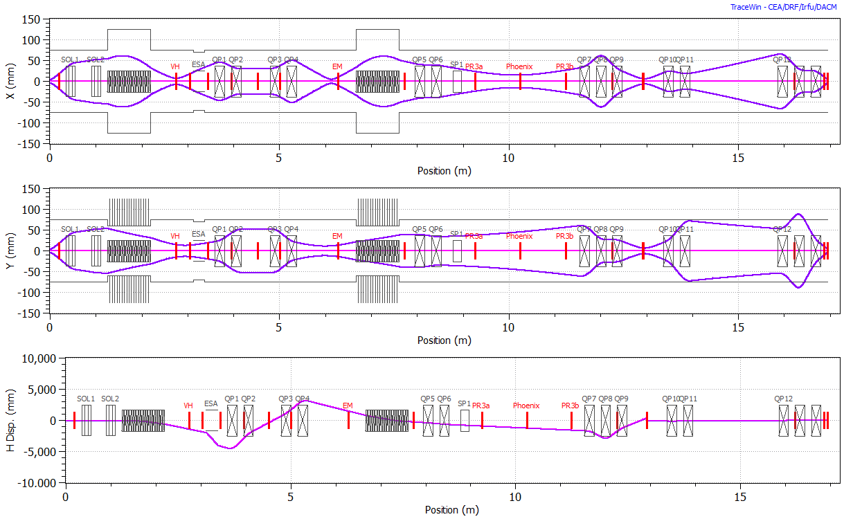

Dear Emil,
If I add a small input energy error one the input beam and tune the line according to both ELECTROSTA_ACC element matrix, I got following results:
You can see that second simulation is much better (second matrix def.). Second point, if you compare tracking result wiht envelop result for a non CW beam, there are big divergences between both with the first matrix.
