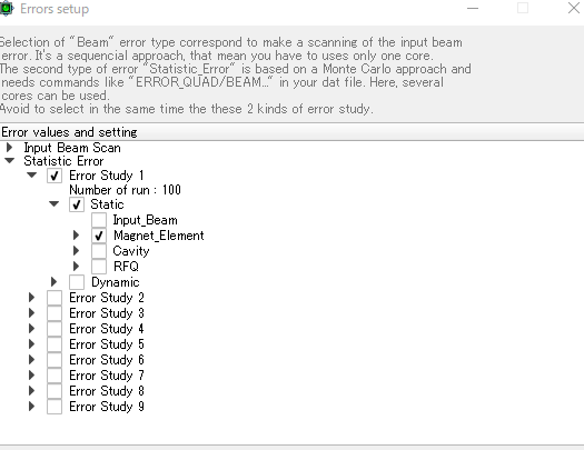

In the Windows Errors setup.
I use the option magnet_element
However, in the output file "Error_data" only the quadrupoles errors were written.
Could you confirm If I that is the correct one of implement bending errors?

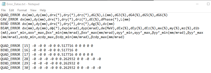

No, your example doesn't work, because first parameter of ERROR_BEND_NCPL_STAT command. Replace '1' by '2' in order to reach at least BEND element.
Doing that 3 'BEND_ERROR...." should appear in error file corresponding to EDGE+BEND+EDGE

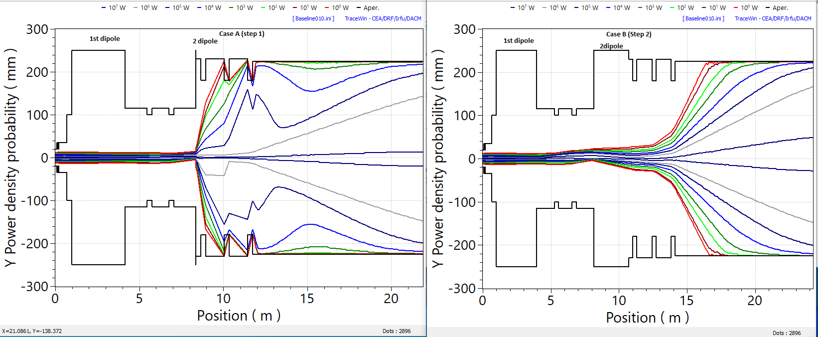

I noticed when I applied error gradients in the bending magnets, something strange happened.
This is how I applied the error.
ERROR_BEND_NCPL_STAT 2 1 0.0 0.0 0. 0. 0. 0.8
EDGE 22.5 4500 250 0.45 2.8 250 1
BEND -45 4500 0 250 1

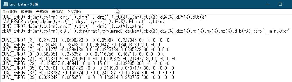

This is the error data file

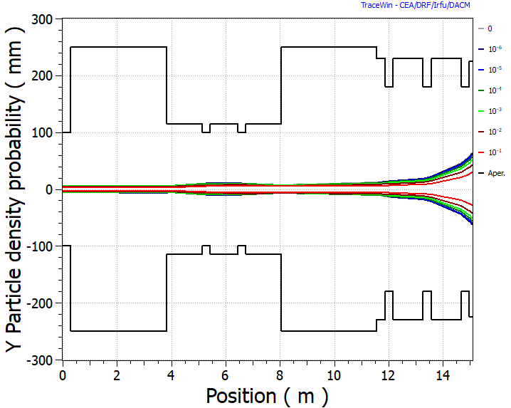

I simulated this static case with two steps.
I plot the results vertical power density for the first step (Case A left) and the 2nd step (Case B right).
As you can see, the length of the second dipole is reduced for the cumulative in the first case. However, for the cumulative statistics of the second case is normal.
Do you have an idea why this happened?
Thanks for the help,

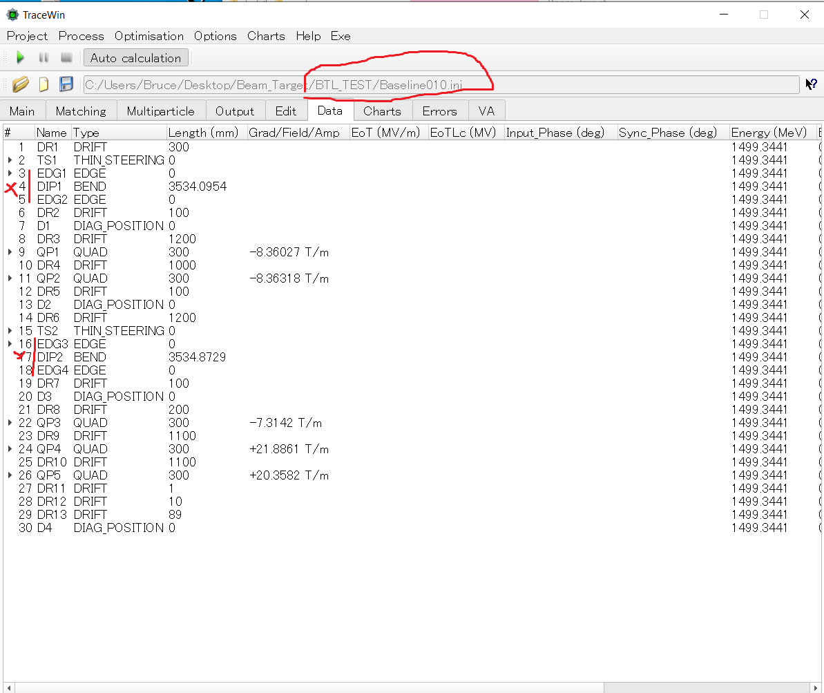

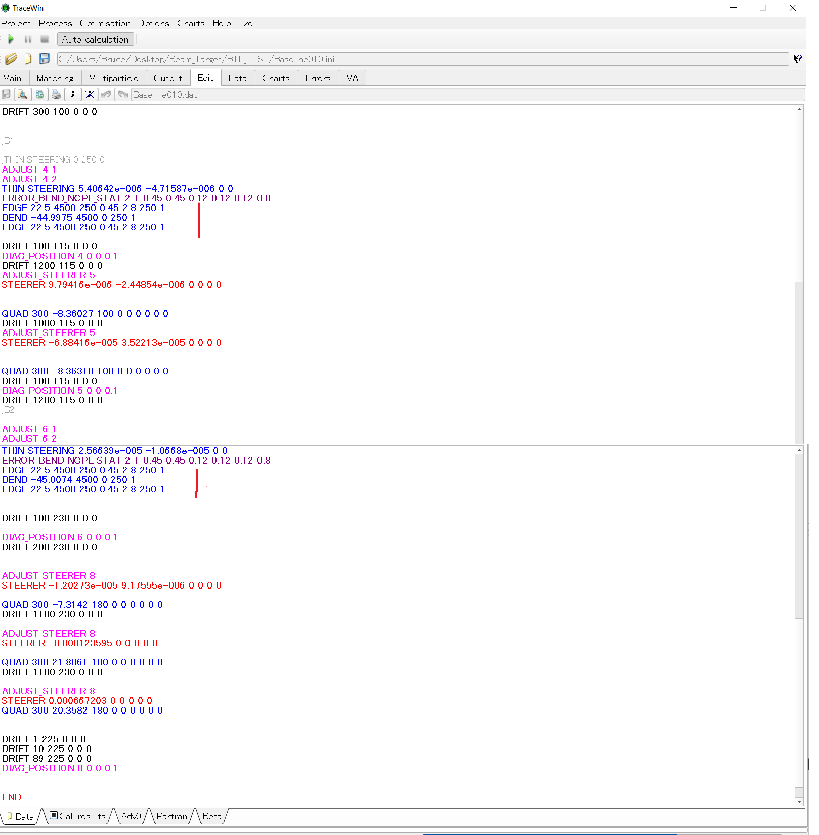

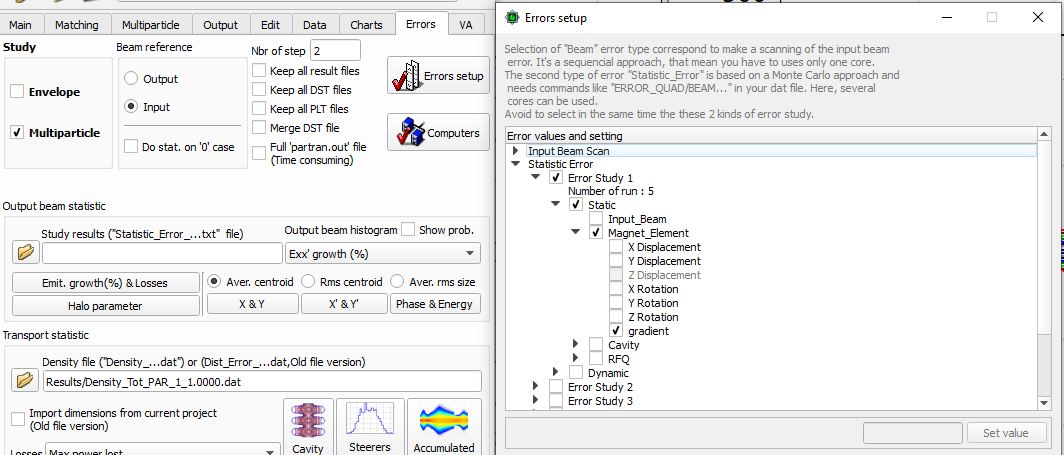

This is a screenshot of the project.
According to my understanding, from the element 3 to 5 is the 1st dipole (Edge+Bend+Edge) and from 16 to 18 the 2nd dipole. (See the red marks)
No cavity is defined.
Similar the lattice.
Could you please tell me in which files did you see you the cavities?
Thanks for your help,
