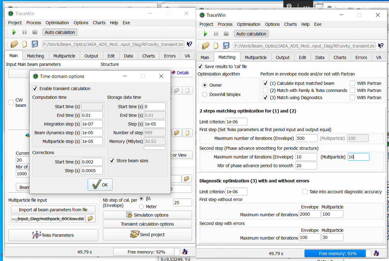

Thank you very much for your advice. I made the setup that you suggested (See the next fig
Those set up (# of interactions) depends on the length of the linac and the numbers of particles. I mean, if the length increased 10 times more, we can use the same number of interactions?. or About the numbers of particles?

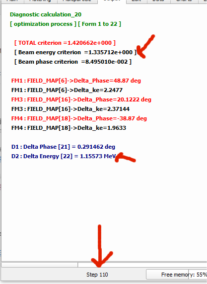

No, the number of iteration mandatory depends of the alogrithm convergence. In this case, you can see in the following figure that for exemple at step=110, penalies function is not good (delta phase and energy not close to 0), so, some more iterations are needed.
When these optimisations are made during the transient calculations, it is probably not necessary to reach the required setpoints, but just to give the right directions to the field and phase, because anyway the cavities cannot change abruptly because of the filling time. However, I don't understand why it's a problem to have a number of step too big, normally it's just more accurate.

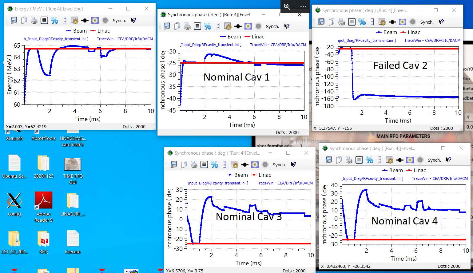

Thank you very much for your help and support. Sorry for abusing your kindness. Unfortunately, I still have some doubts about how the compensation is done in the transient-state.
I testing the update code by using the following procedure.
1) I verify if the correction scheme works in the steady-state. For this, I simulate the worst-case scenario based on the
transient behavior of the faulty-cavity (phi change to -140 deg and accelerating gradient the same as nominal). The input files that I used are in this folder(

2) Based on the Steady-state folder, I simulated the transient-state using the attached example.
TEST000_Transient-State.zip
(6.13 KiB) Downloaded 568 times

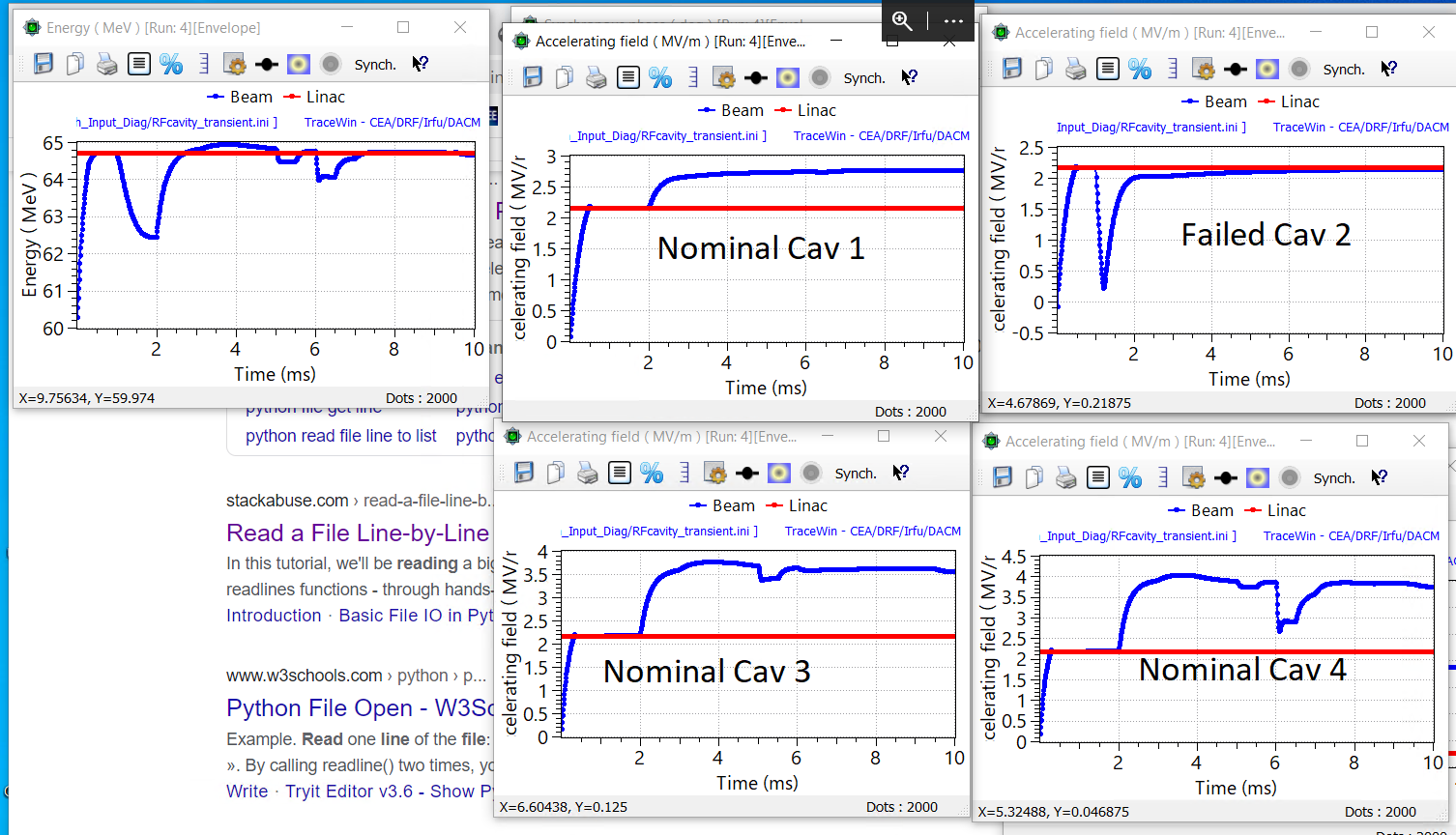

. The limit values for the adjustment (MargeField and MargePhase) are consistent with the Steady-state case.
In the attached folder, the phase and field are under the limits; however, the change in phase for the rest of the compensate cavities is beyond that limit.
I could not achieve a good compensation in terms of energy. As you suggested in the previous ones, I changed the numbers of interactions (I made a scan from 5 to 100, then, I tested 200, 500 and 1000).
My understanding is that the steady-state could be considered the same as the transient-time for a specific time. For example, if the transient time simulation takes 10 ms and the beam dynamics steps are 1 ms. This is equivalent to make 10 simulations in the steady-state, in which we should provide the value of the phase and accelerating field of the faulty cavity at each step time, right?
My doubts are:
1) How the correction is done in transient-time? Is it the same as the steady-state?
2) For the steady-state, there is a convergency as a function of the number of interactions. However, the transient time showed that the value of 6 interactions provides better results than 50, 100, 200, etc. but 5 interactions provide similar values than 50, 100, 200, etc. Why?
3) Can we compare the steady-state and the transient?
Apologies for the long email, thanks again for the help and support.
