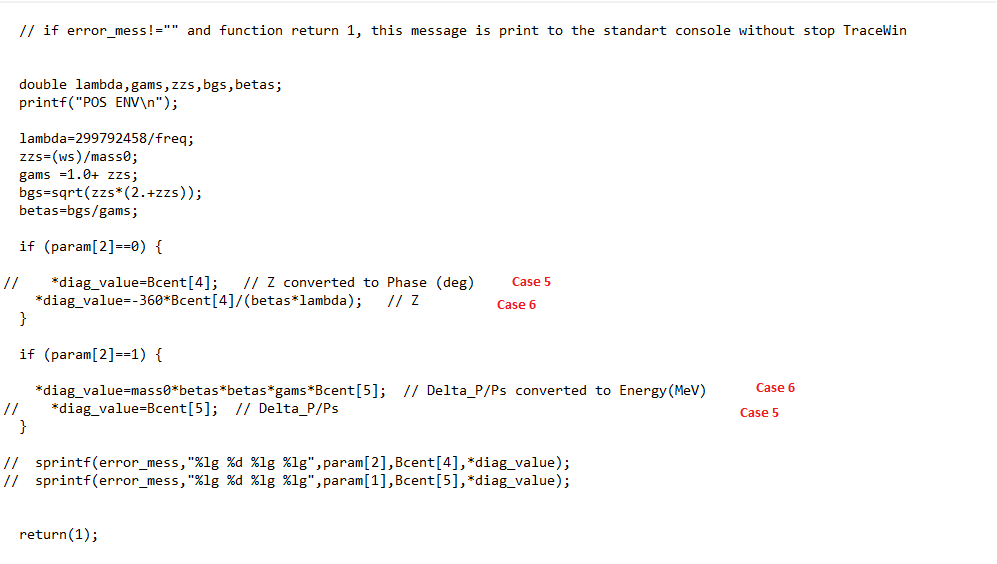

Following the early discussion. I created my own diagnostic.
main.cpp
(4.94 KiB) Downloaded 403 times
I used Bcent[4] for Z centroid and Bcent[5] for Deltap/ps.
For Case 5, I asked to compensate Z and Delta p. And for Case6, I computed the corresponding phase and energy.
In these two cases, I compared with the diagnostic "Denergy" and "Dphase" (Called case 4).

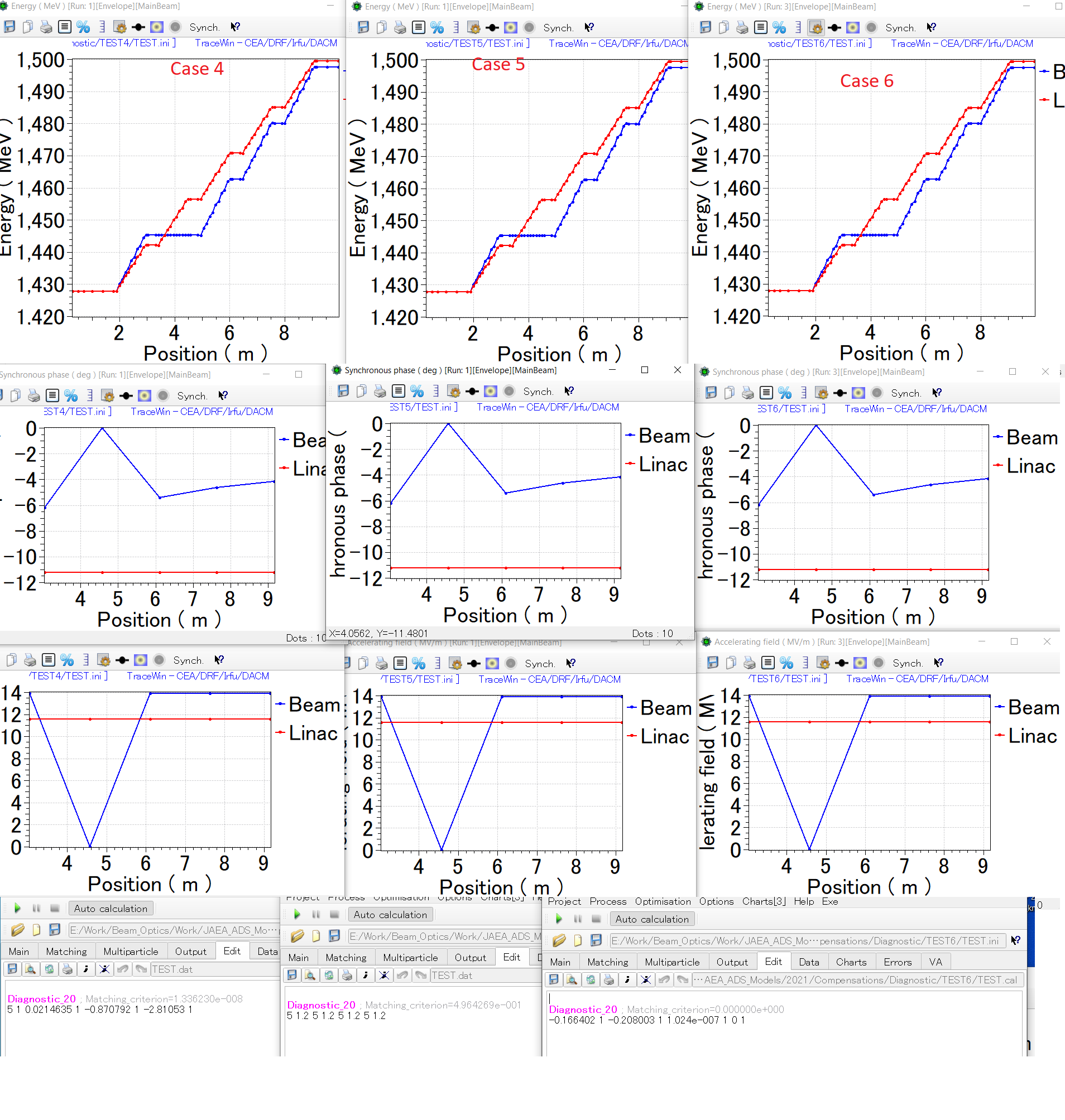

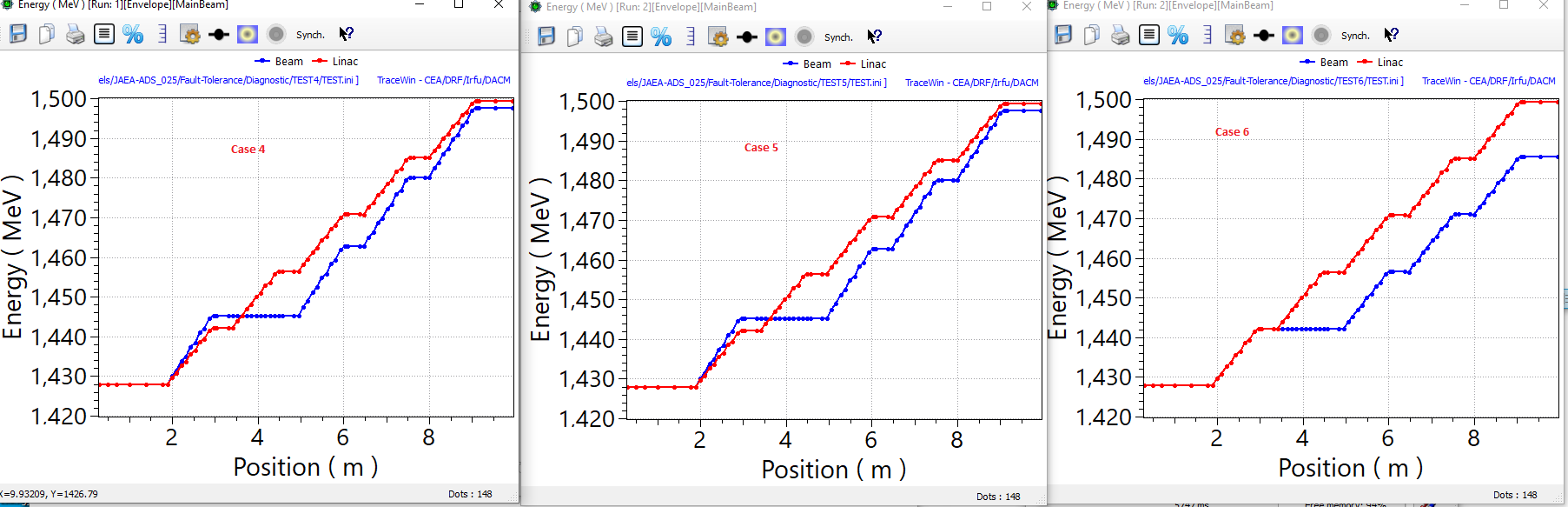

The energy compensation results are:

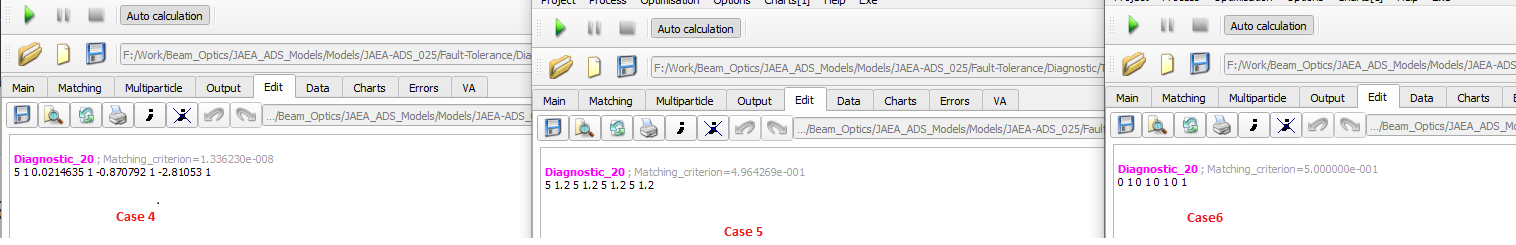

As you see the Case 4(default diagnostic in TraceWin) and Case 5 produce similar results. But, Case 6 has a poor performance.
The results of the diagnostic are different for the 3 cases.

I believe that I have some problems with the energy conversion. However, I used the same equation that is in the example program.
Could you tell me what is missing in Case 6 to reproduce the results of the two previous cases?
Thanks for the help and support.
Re: Develop its own diagnostic
Ok I got exactly your results. Good point
But, something seems strange for me considering your syntax.
MY_DIAG (d_ene_pha) 20 0 0  ;  That means: parm[1]=0  &  parm[2]=0
MY_DIAG (d_ene_pha) 20 1 0 ;   That means: parm[1]=1  &  parm[2]=0
You never use your dp/p or energy criteria but you change your target either to 1 or to 0 on the Z or phase
