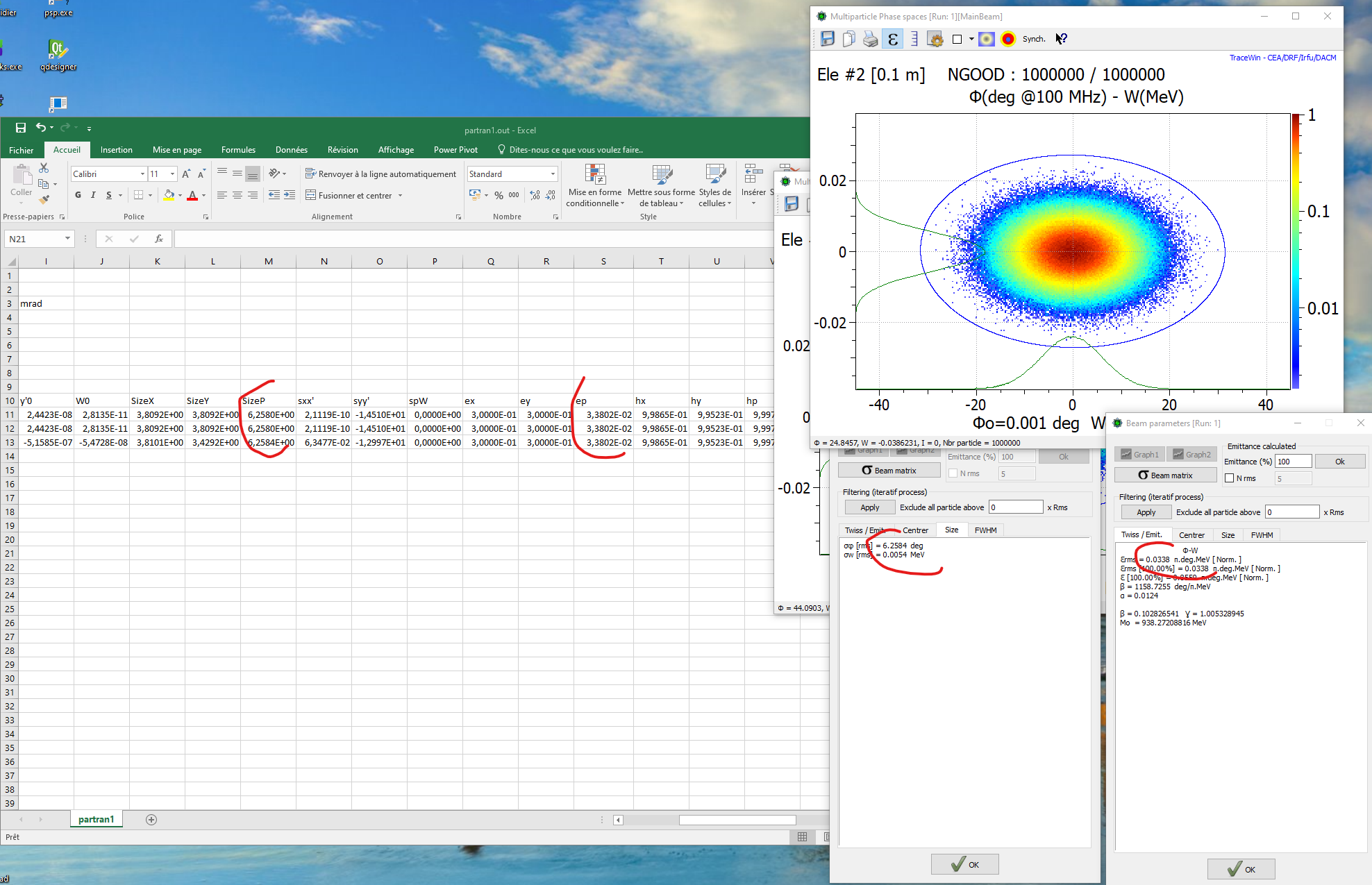

Dear shliu,
Using your example, I didn't get exactly your values!
But on my side, they're the same!
(see picture below)
